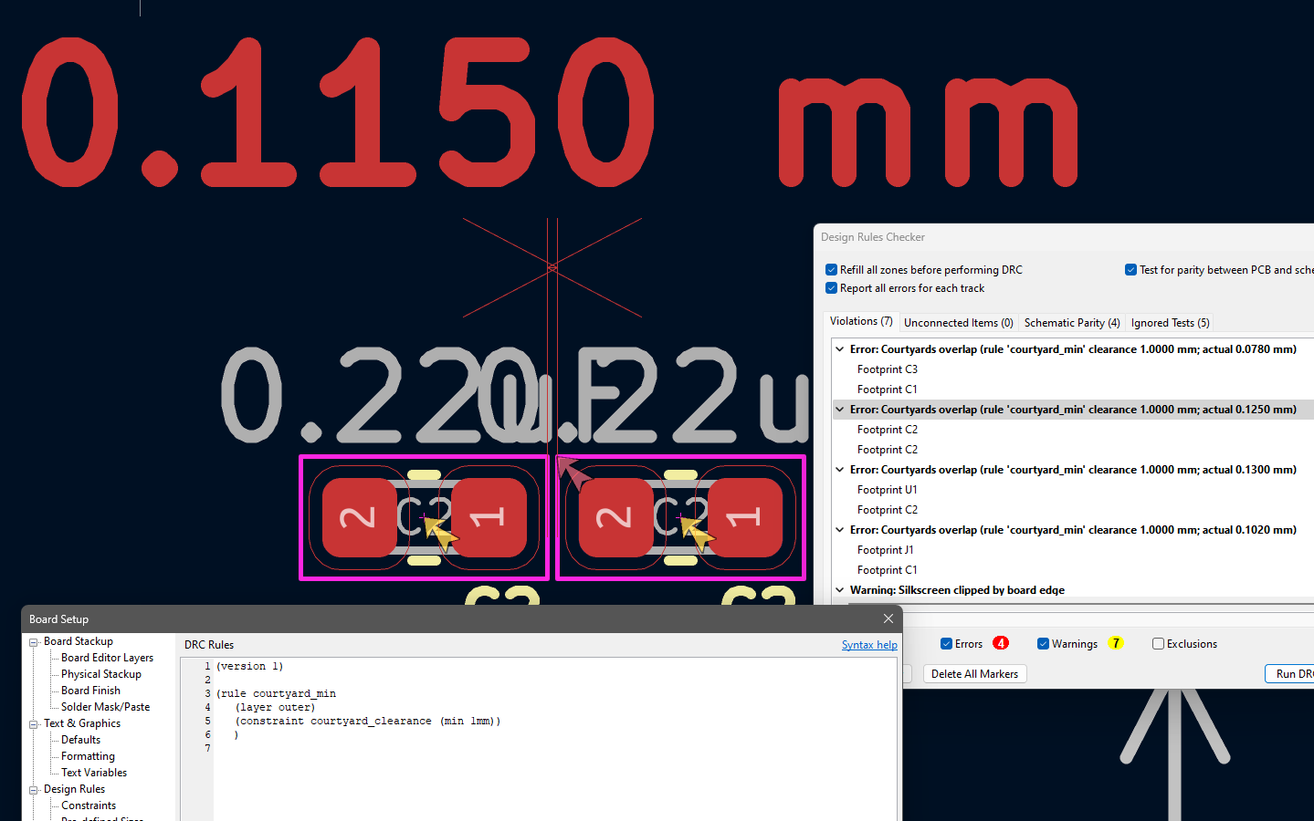

Clearance between courtyards
(rule courtyard_min
    (layer outer)
    (constraint courtyard_clearance (min 1mm))
Posted by Naib in: Is it set a minimum distance between components in KiCad PCB Designer? - #9 by Naib
