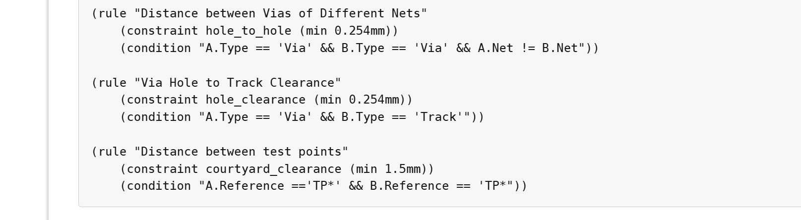

I am really stuggling with the custom rules in KiCAD 9.
I tried to define a custom rule for the clearance between the testpoints. The state of the rule checker is No errors found. But the rule is not active and there is no error in the DRC.
I defined the custom rule:
For whole footprints you can use courtyard_clearance, as you can see in the example rule. For that both footprints must actually have a valid courtyard.

I changed my rule to courtyard_clearance but it is still not working.

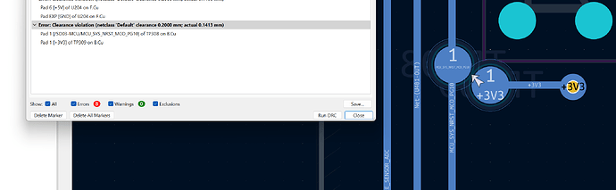

Is it a problem, that I have integrated the center point of my testpoint on the courtyard layer? I attached a few pictures to show you the footprint and the rule.
As Rabbit described the testpoint needed a bigger clearance to each testpoint, but not to all the other component. Normally the pcb are full of components and the components have a smaller grid then 2.54mm so it is no option to set the overall clearance or the grid to 2.54mm.
Yes, possibly / probably.
The courtyard is supposed to be a “perfect” shape resulting in the circumference of an enclosed area. I have not verified it, but I guess the constraints are the same as for the Edge.Cuts layer. To test whether your rule works, test it with some default footprints or draw only a rectangle on the courtyard layer. If that works, then draw only a circle on the courtyard layer. (I just verified that a circle on Edge.Cuts results in a round PCB in the 3D viewer, so that works as expected).
