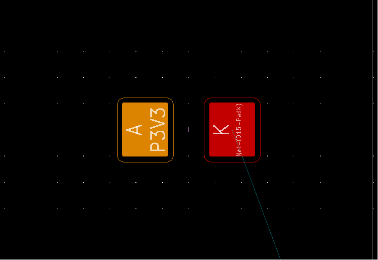

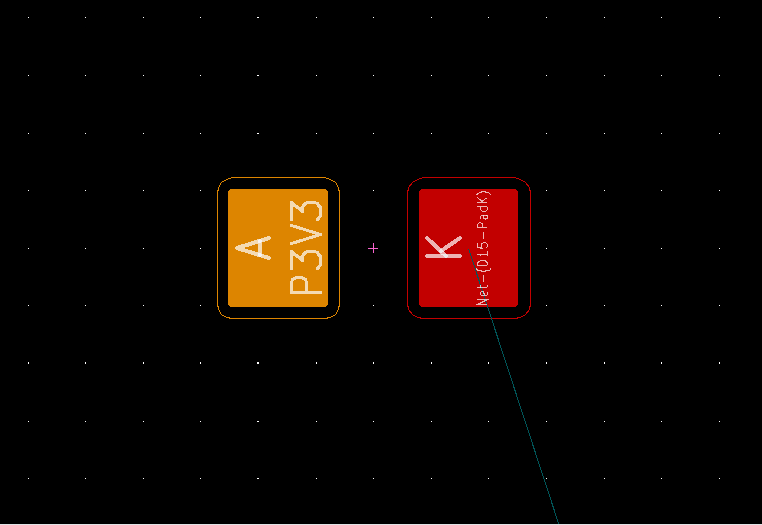

John, I do have warp turned on and it’s what helps align a part to the grid. Below is a comparison between 9.0.3 and 9.0.4. With 9.0.4 I can’t get the part to place on the grid. I hope I’m doing something wrong.
9.0.3
KiCad_9.0.3

9.0.4
KiCad_9.0.4

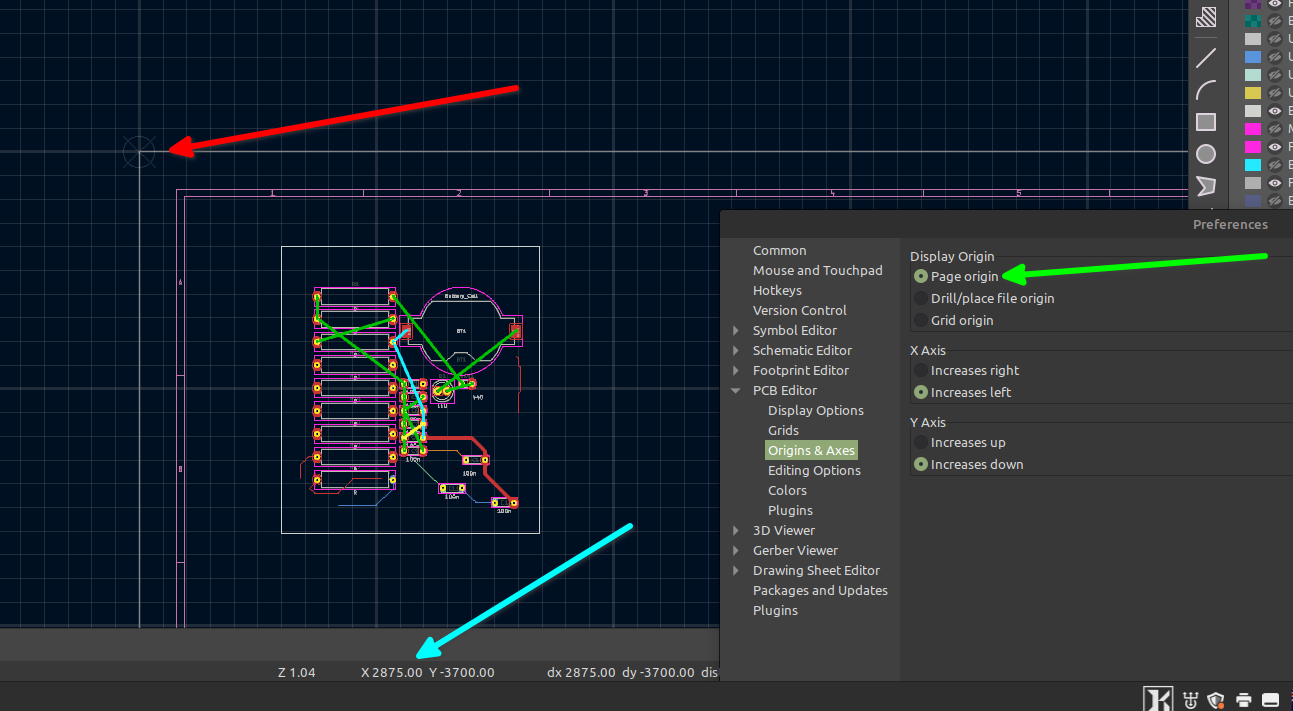

The Page Origin is the Top Left Hand corner of the page with which you are working (Red arrow). It doesn’t matter what size page you are using.
If Preferences > PCB Editor > Origins and Axes > Display Origin is set to Page Origin (Green arrow), the X & Y values (Cyan arrow) will display X = 0 & Y = 0 when your cursor is exactly over the Page Origin.
If you look carefully, you may see that I have placed the Grid Origin on the Page Origin. You will need to zoom right in, to position the Grid origin on the Page Origin, accurately.
It seems once this has been done and you have tried moving an item or two, the system has set itself properly and the problem no longer occurs. You may also then move the Grid Origin off the Page Origin with no further consequences, including closing and opening Kicad or importing or whatever.

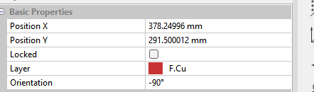

I’ve notice another weird snapping behaviour.
I’m on 9.0.4 on Windows 11
Grid set to 0.25mm

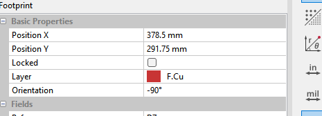

Original position on the grid:
After dragging 0.25mm left and down the position is close to grid, but has lots of decimal places (should be 378.25, 291.50):
This happens each time I drag it.
