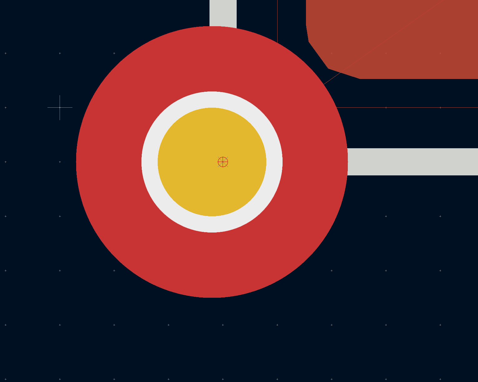

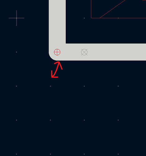

I have been working on a PCB and I had a predetermined grid origin - everything aligned on this grid however now when i try place items on the grid they get offset: see the via. Even when I try and replace the grid origin it comes a little offset so this means everything else becomes instantly off grid. Has anyone faced this how can i fix it?

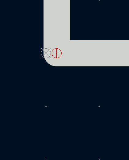

In this image originally drill origin and grid origin were aligned. After I replace the the grid origin there is some offset as I cannot place it in the exact spot it used to be.

There have been grid/origin issues on 9.0.4 there are a few recent posts on the subject, have a search/look on this forum.

I guess is the latest version so that makes sense. I didn’t see other posts. I will check thanks
This Forum thread is about your issue.
You may try the temporary fix I mentioned. It may work for you.
The issue has been fixed for 9.0.5 and may be available now as the 9.0.5 Testing build. See downloads in https://www.kicad.org
