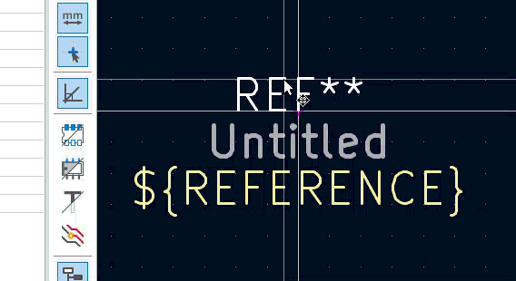

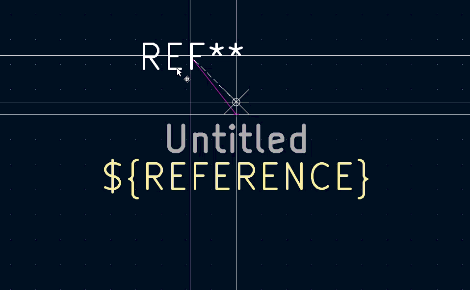

9.0.4 Strange Part Move/Grid Snap Behavior
Re-tweaked grid origin by the fraction as per my post above and it seems like it’s all good!
Very happy as on bigger project positioning footprints drove me crazy!
I think the developers would like an environment where they can reproduce the symptoms, so if you provide the set of data you are currently editing (two cases: when the symptoms occur and when they can be improved), it will be easier for others to reproduce and investigate.
I’m with you, but the issue it fixed. It was a mistake on my end (by missing the page grid by 0.00004 mm).
PCB Editor / Place / Reset Grid Origin should do it.
With a right click and from the context menu: Grid Origin, you can also enter absolute coordinates for the grid origin.
