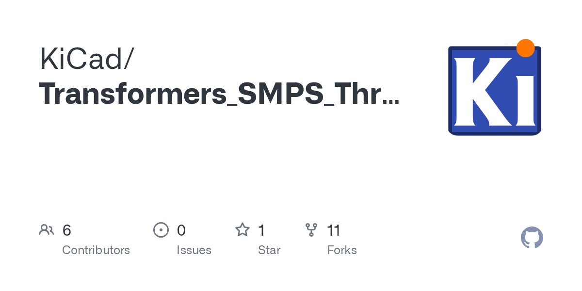

I have a footprint-problem, too.
I have replaced the fp-lib-table with the fp-lib-table.for-github, as written here, but that did not help.
Here is the Error Message:
Error loading netlist.
IO_ERROR: http GET command failed
Cannot get/download Zip archive: ‘https://codeload.github.com/KiCad/Transformers_SMPS_ThroughHole.pretty/zip/master
for library path 'https://github.com/KiCad/Transformers_SMPS_ThroughHole.prety.
Reason: ‘End of file’
from /build/kicad-WeUYPs/kicad-4.0.0/kicad/pcbnew/github/github_plugin.cpp:remote_get_zip():line 584
I am totaly new to kicad, this is my first try to “design” something with kicad, so I do know nothing about the principles behind all that “magic” thats going on in kicad.
Could someone please tell me, what the reason of this error is and how to avoid it?
Thanx in advance
#15
with the correct spelling that is a valid library path:
if you are on linux you can compare your actual fp-lib-table against the one on github with something like
$ diff <(cat .config/kicad/fp-lib-table) <(curl -s https://raw.githubusercontent.com/KiCad/kicad-library/master/template/fp-lib-table.for-github)
#16
@Anders_Wallin: Thank you very much for your answer.
The wrong spelling was a typo made by me, because I had to type the popup-message by hand…
I meanwhile have seen, that there is a footprint-library-wizzard and I have used it :wink:
It seems, that it has checked footprints on Github and has importetd them (all but one [ something like “Label” or so])
So it seems to work now, after a while, I found all footprints and learned how to get them into the pcbnew … its hard to understand that all, but seems to be possible :wink:
