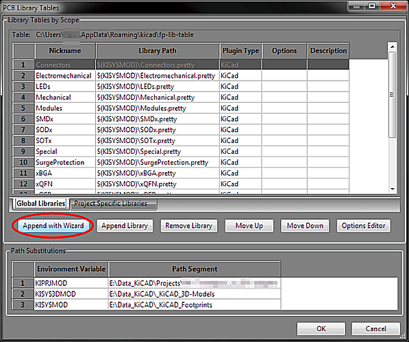

If you open PCBnew or the FP editor and under
Preferences>LibraryManagementXYZ
you choose to use the Wizard to append libraries (either via this button)
or directly via the preferences menu, there should be an automatism there that will scourge the KiCAD github repo for footprint libs and put them into that list.
If you want to start fresh - remove all libs in there beforehand.
If you run local libs, you don’t want to do that, unless you want to run the github libs locally, then follow @bobc 's guide on that.
In all other cases, you modify the fp-lib-table filer either in above dialog your self (and set it up to look on your harddrive for your local self-managed libraries) or you edit it outside of KiCAD with a text editor.
PS: as you can see, I run them locally, using the KISYSMOD environment variable, pointing at a folder on my E: drive. All libs then use this varaible as part of the path and are located there.
If I use another computer, I can move the whole lot and just change the path variable and be done.

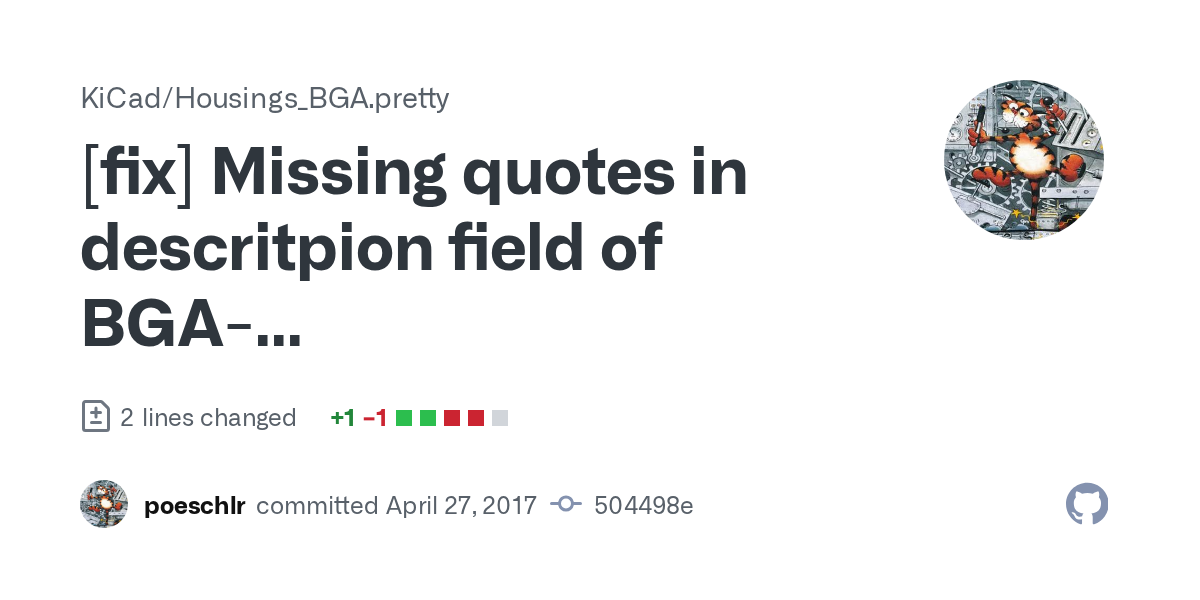

This issue was due to a faulty footprint in github library
The reason the problem persists after a re-install, is because the online libraries were still being used.
