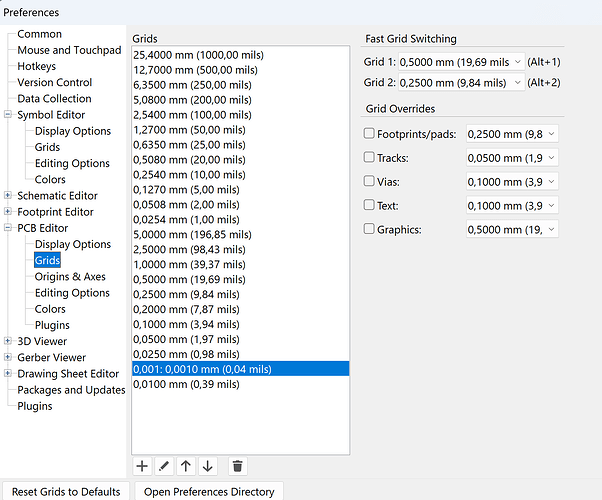

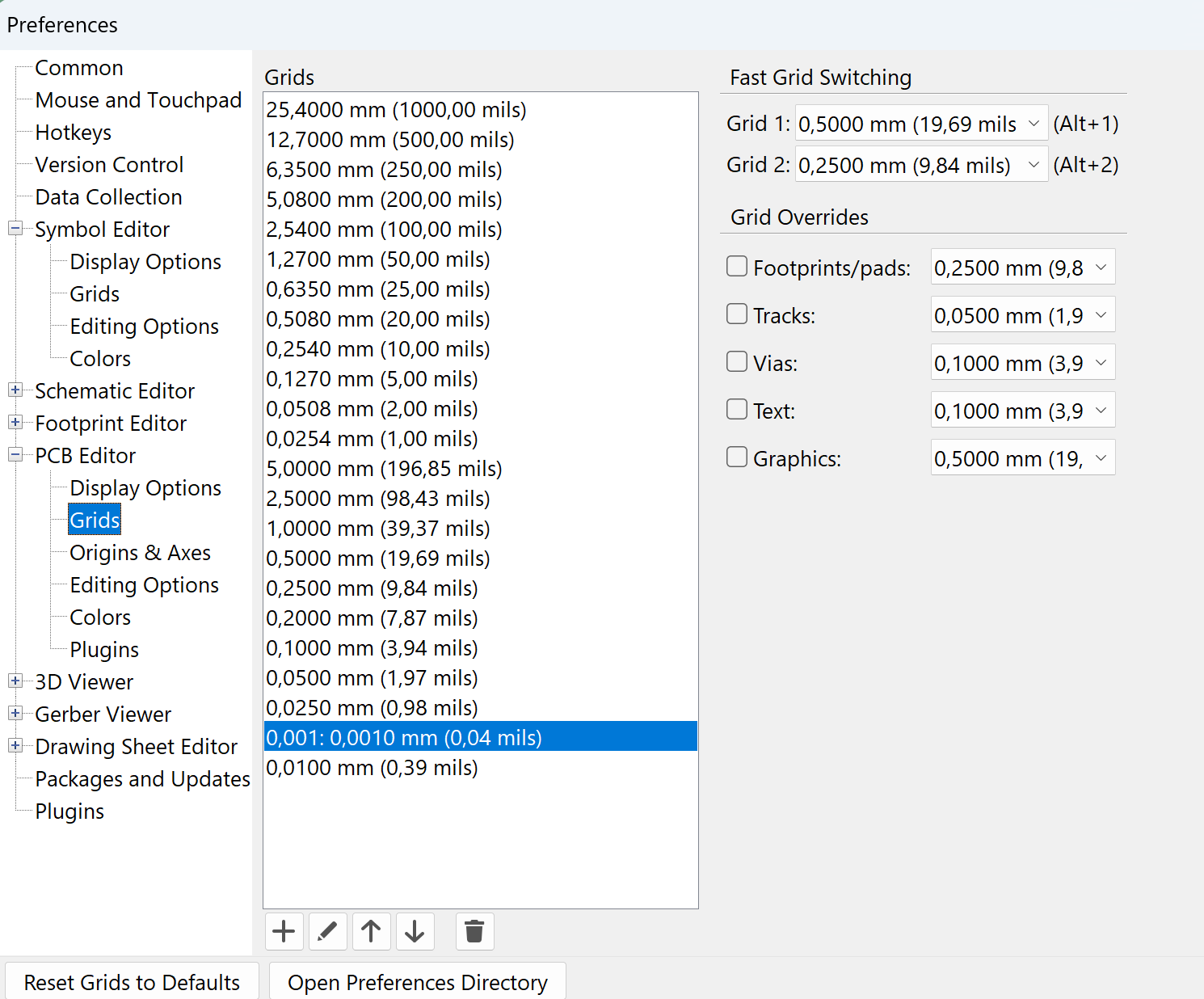

Grid settings
Users can create custom grids for quick selecting from the Editor’s toolbar dropdown menu. There are also keyboard shortcuts for two alternative grids.
Grid overrides
Grid overrides can be very handy. Often different kinds of items need different resolutions for the grid. This can be especially important in the Schematic Editor which also has its own Grid settings. “Connected items” must always be in the same grid, and changing grid for pin placement in symbols and symbol placement in the schematic will probably ruin the schematic. Grid overrides makes it possible to keep the critical Connected items grid the same while allowing arbitrary text and graphics positioning without actually changing the common grid.
