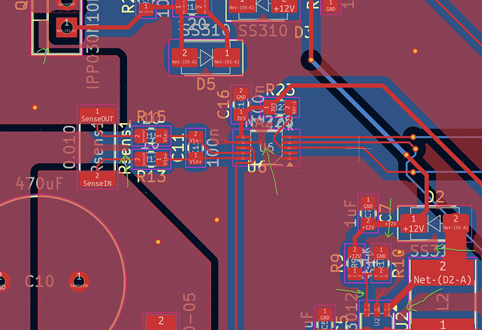

Hi, I am pretty new into the pcb design and trying to design my first PCB. I used zone fills for grounds but then there exist some pointy-spiky copper fills and I heard this kind of layout may act as antenna and cause some magnetic interference. Is it true that this kind of things can cause problems and if yes how can I get rid of this while using zone fills.
I attached the screenshot and pointed the areas that I am mentioning with green arrows
In my opinion they are not problems provided you short them by via with continuous GND plane at the other layer. Generally in this PCB I would use much more GND vias.

Those small stubs are not a problem (until you get into the really high frequency HF stuff). Routing long tracks though the GND panes and cutting them up into little pieces is a huge problem, and a typical beginners mistake. To keep it “simple” for you, and yet effective: just don’t put any hole in the GND plane that is bigger then around 3mm.

I mean my ground fills go under the ICs for no reason and I dont think its good to have a high current ground under a small IC, how can I adjust ground fills so that they dont go under the ICs ?
You want ground under the IC’s.
Assuming that your ICs are connected to ground at some point, it keeps loop currents low.
But - in the image you shared at first, is the blue plane also ground? If so, you need to connect the top and bottom ground planes together with a lot of vias. Especially look at U6 - it looks like you have two pins (1&2) connected to the top plane, but not the bottom. Don’t do that.

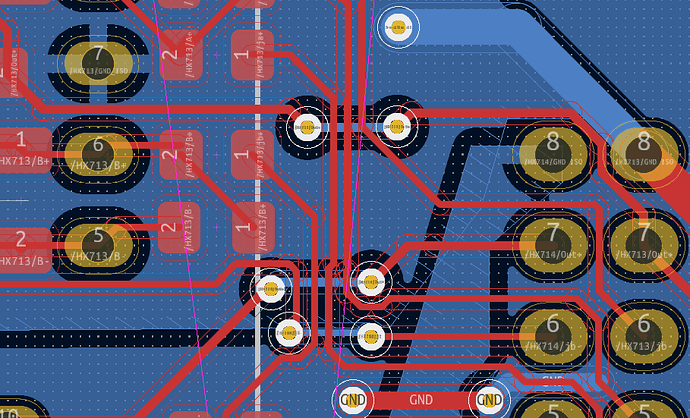

  1. Good footprint placement comes first, and the goal is to avoid tracks crossing each other.
  2. Track length is not really important (unless length matching etc is a requirement). It’s most often better to run a longer track on the top, then make (even a) short hole in the bottom GND plane.
  3. If tracks really have to cross each other, then keep as much of both tracks on the top layer as you can.
  4. It’s life there are always compromises. Projects you find on the internet vary widely in quality.
Below a simple example (Unfinished layout).
With the top track, I kept the “dog bone” on the bottom completely within the zone, so GND currents can run around it.
With the bottom two tracks, they are in the corner of a zone, and in that particular area the GND zone is not effective anyway. Also note that these signals are very low speed. They go to an ADC that takes 100 samples per second at most. All zones you see are from different GND zones. This is part of a frontend of several ADC’s with galvanically isolated inputs. It’s not a “typical” digital design.
How should I connect them to the bottom plane ?
If you have both a top and bottom ground plane (or fill), every ground “island” needs to be electrically connected. Just use the via tool and place vias throughout the islands. Unless your circuit is RF (which requires careful layout), you can just try to put a via every cm or so.
