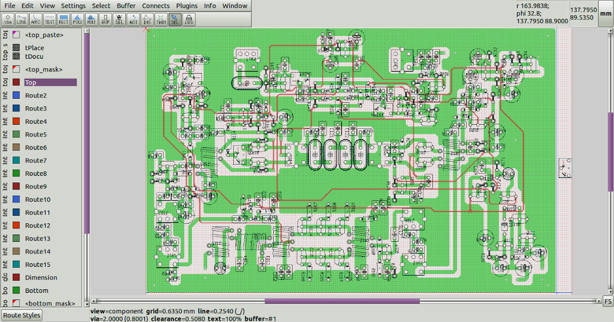

There is now support for loading Eagle binary layouts and libraries (versions 3,4 and 5) in the FOSS layout tool pcb-rnd, see:
and
after which a simple “save as” gets you to either Kicad legacy or Kicad s-expression format. The only major issue I envisage that could arise during conversion will be clearances for polygons around pins, pads and vias. The netlist information for components should make it over to Kicad format, but the netlist information for polygons will be lost.
Generally speaking, Eagle polygons are not zones in the way Kicad polygons are, so pullbacks/clearances around their perimeters in kicad may also differ to those in native Eagle representations, and via clearances may not convert simply.

There is no schematic import at this stage.
The Eagle binary tree -> XML tree conversion code is GPL v2.0, and there are only a few additional 24 byte binary block types used for the schematics over and above the binary block types used for layouts, since they share wire, arc, rectangle, circle, text and similar geometric block types and populate the same basic binary tree structure.
Most of the framework is there if someone wants to effect a stand alone conversion utility in C for layouts, libraries and/or with a bit of extra effort, schematics. I may have a go at adding the code for schematics in due course, but my primary focus was unlocking the many amateur radio open hardware PCB designs floating around in binary format.
