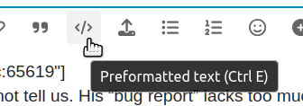

When you attempt to run a simulation in KiCad. It logs a lot of informational and error messages. Copy that text and post it here, in between “reformatted text” tags.
