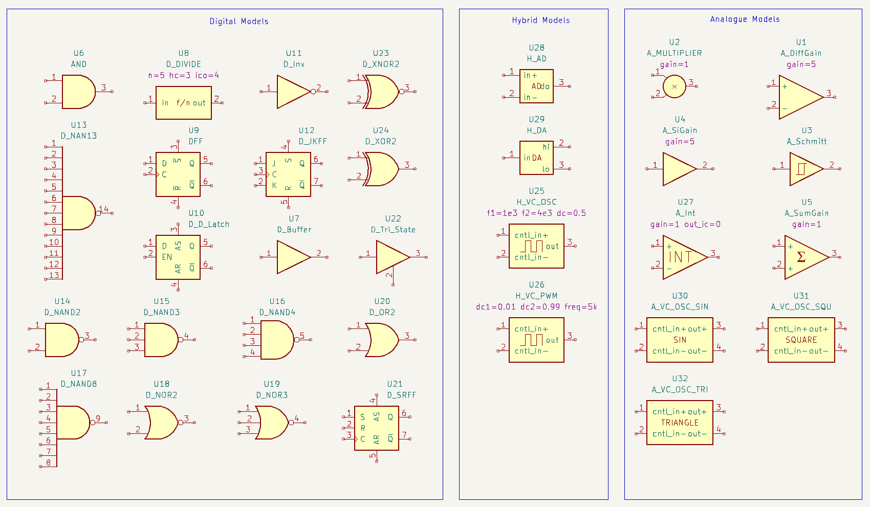

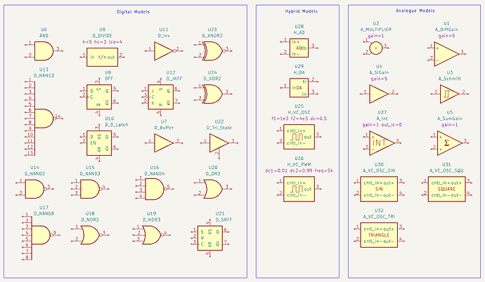

Currently ngspice contains 68 code models, ranging from simple elements like analog gain cells or digital inverters up to complex ones like a digital state machine , SRAMs, 3D table models or interfaces to digital Verilog building blocks compiled with Verilator.
I have created a symbol library for KiCad 8, containing digital and hybrid symbols. It is accompanied by the associated simulation model library. Enhancement by analog symbols and models will follow.
XSPICE-symbols-models.7z (4.0 KB)
Both symbols and models are made to be integrated into the KiCad symbol library. Therefore the installation even now requires to copy both files (Simulation_XSPICE.kicad_sym and Simulation_XSPICE.sp) into the location where the standard symbol library resides (e.g. C:\Program Files\KiCad\8.0\share\kicad\symbols on MS Windows). Then they have to be added to the available libraries by Eeschema β†’ Preferences β†’ Manage Symbol libraries β†’ + β†’ Select the library path and add a nickname (Simulation_XSPICE for example).

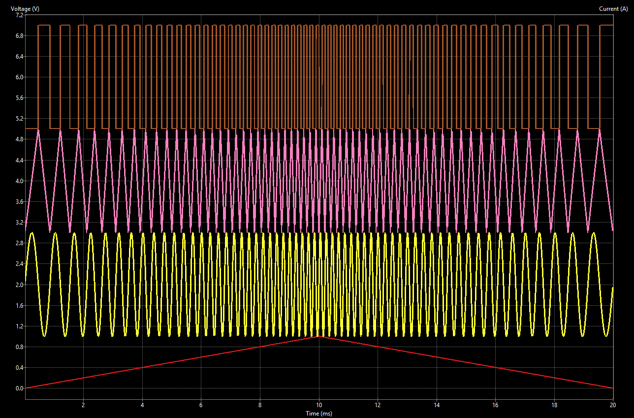

A 4-bit counter with JKFFs
A divide by 4 with 2 DFFs

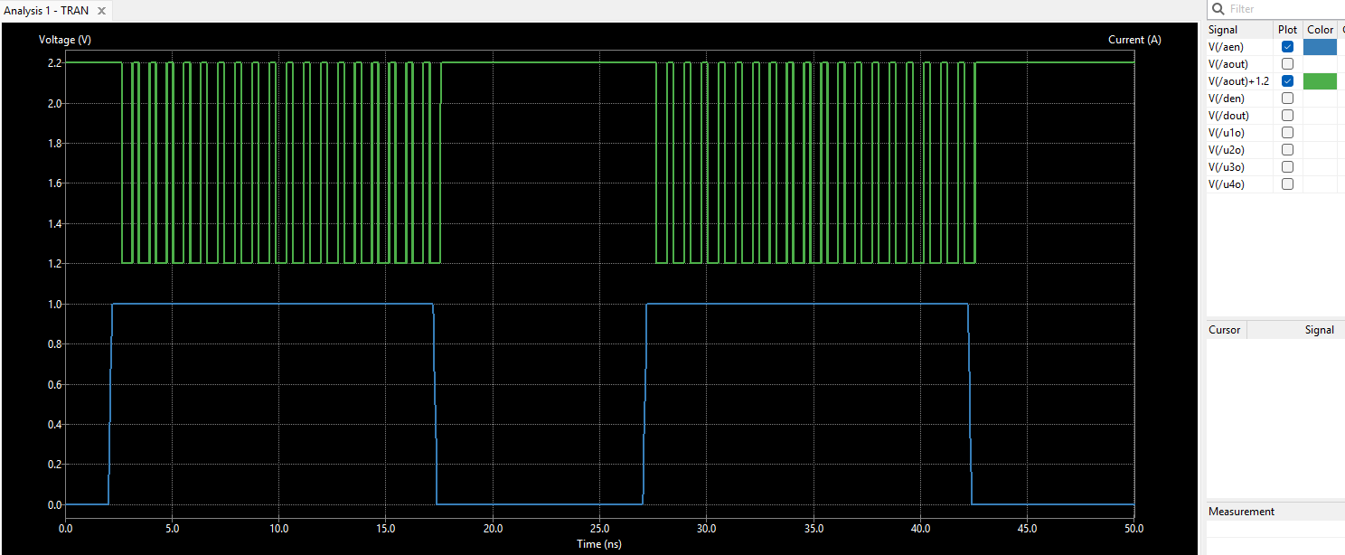

A voltage controlled oscillator and a voltage controlled pulse width modulator (both are hybrid models, analog in, digital out).
with result
Plotting is sometimes done using a ngspice script writing a VCD file and then starting GTKWAVE to plot it. The Eeschema plotter currently does not support plotting digital data (except for you will change them to analog by adding a resistor to the specific node).

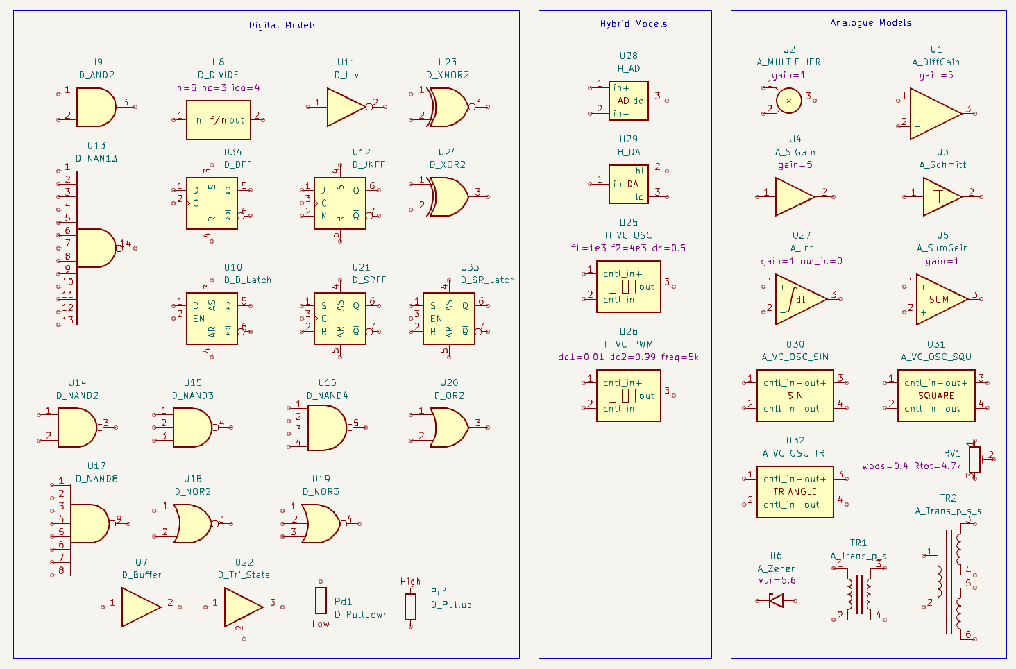

These are symbols you find in the update (analog, hybrid, digital):
Another update is available:
XSPICE-symbols-models-4.7z (5.6 KB)
The next update is here:
XSPICE-symbols-models-5.7z (5.7 KB)
Edit: Updated
