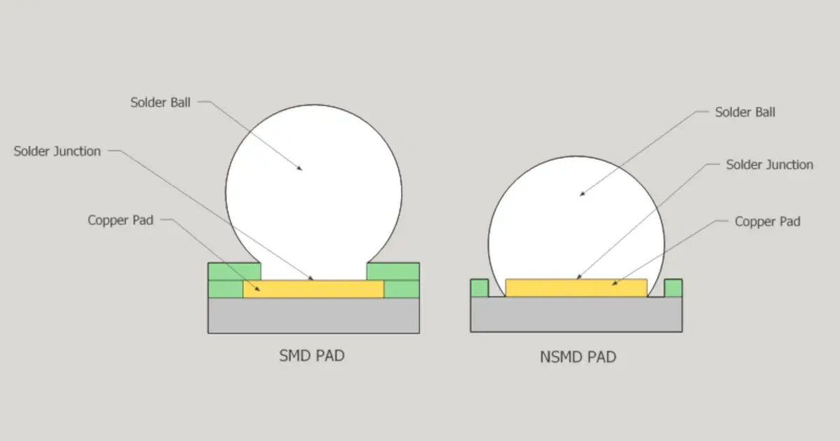

This provides clearer drawings to illustrate the difference between NSMD and SMD pads, whereas the link provided by @paulvdh covers the pros and cons of each.
Whether a pad is of NSMD or SMD type clearly applies to the 28 pins of the IC - but my understanding is that such terminologies are of little or no relevance to the thermal pad, other than how the solder mask may or may not overlap the copper pad at its perimeter edges.
These TI documents (which I have yet to study in detail) reinforce my impression that the terminology of NSMD or SMD is only of relevance at the edges of copper pads.
It seems fruitless to consider what type of definition terminology to use for a solder paste blob sitting within a copper surface, the edges of the blob being defined by solder mask/ the stencil.
For such, only SMD can apply.
Only at the perimeter of the copper pads are the alternatives of NSMD or SMD available, depending on whether there is a positive or negative overlap of the paste relative to the edge of the copper.
In what regard is this whole thing relevant to what you are doing?
KiCad’s default footprints are fine for most general work. Have you actually encountered some problem that you need to fix? Just because some Kelly guy somewhere on the 'net has a proposal for some complicated thermal pad design does not mean you have to implement or even read it.
Same for those (Non-) Solder mask defined pads. It’s good to know those solder mask pads exist, but I’ve never used them myself, as far as I know they are used in some “special cases” but I don’t really know (nor care) what those situations are. So why spend (much) time and effort on the topic at all?
It is.
NSMD the resist is wider than the pad: the usable area is NOT defined by the solder mask - provides edge adhesion.
SMD is where the resist is smaller than the pd: The usable area IS defined by the solder mask

AN2467 page 14: (alternative to the solder mask defined)
the exposed pad solder land can be split up into a pad array of single Cu pads as shown below in Figure 22 (the so-called copper-defined or NSMD approach, as in the caption to that figure).
In contrast, the Kicad example uses one large, non-segmented copper pad.
Only F.Paste and F.Mask are enabled in the following to make it easier to understand what is going on.
F.mask seems to be a single large rectangle of the thermal pad size.
Being the negative, that will result in the overall thermal pad sized copper of the PCB being fully exposed.
F.paste consists of 6 blobs of solder paste sitting on that continuous surface of copper.
Since the segments are not ‘copper-defined’ but only segmented in the sense of several solder blobs being deposited, there are differences in how the solder will flow (i.e., presumably in a less well defined way).
Gaps between multiple segmented small copper pads with bare PCB material between them would tend to keep the solder within the solder blob (stencil rounded rectangle) areas.
This aspect appears to make the associated question as to whether or not vias should be tented of increased relevance.
