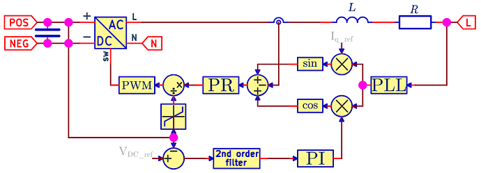

Hi everyone, I’d like to share an idea for using KiCad in a somewhat unconventional way.
While I was preparing for an exam, I needed a way to create clean and good-looking drawings of various control systems, block diagrams, and electrical schematics. Unfortunately, I don’t know of any free software that is really well suited for drawing this kind of material. Of course, you can try using https://www.photopea.com/ or, in the worst case, GIMP or Paint, but drawing every line and every vector manually in those tools takes a lot of time.
At some point, I had the idea: why not use the KiCad Schematic Editor instead?
Its graphical capabilities are actually quite powerful and flexible.

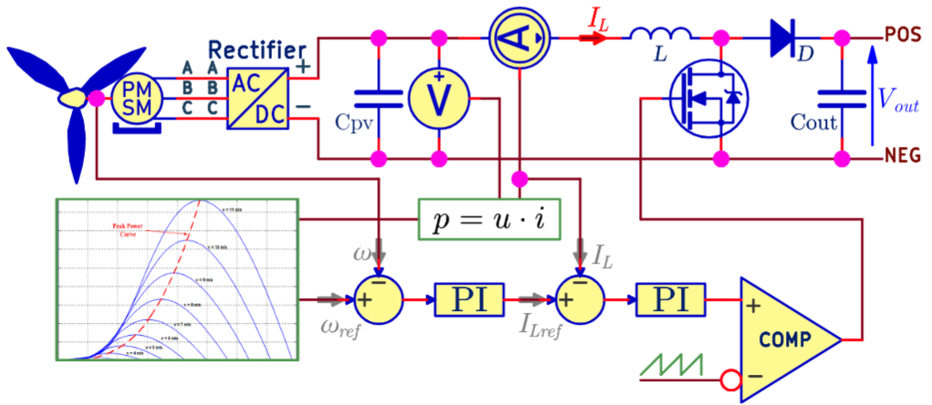

Using it, I managed to create a set of custom symbols, and in the end I got some pretty decent-looking diagrams. The coolest part is that everything is vector-based, so the drawings keep their quality at any scale.
While working on these diagrams, I also came up with a few ideas on how KiCad’s functionality could be extended.
It would be really nice if the text editor allowed writing formulas using a syntax similar to Typst (open source) or LaTeX, with those formulas being rendered in the same “mathematical” style. Ideally, by pressing a simulation button, these diagrams could then be simulated in a way similar to PLECS. However, I doubt that there are open-source simulators as fast as NGSpice that are specifically designed for simulating control systems.
The second idea is probably unrealistic, but the first one might actually be doable. I’m considering forking the KiCad source code and trying to implement such a formula parser myself - who knows, maybe it could work.

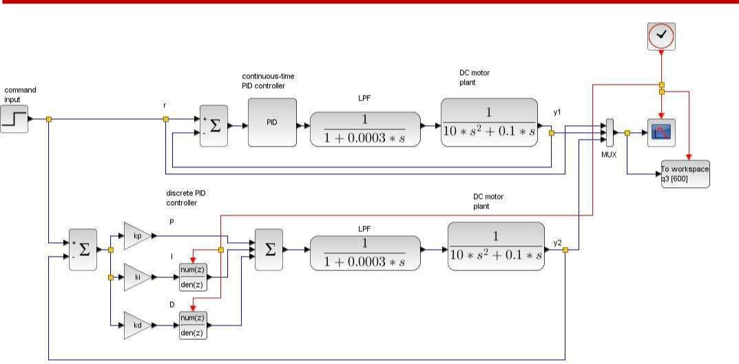

But there already is (Open Source) software that can do this. Below a screenshot of an PID controller from Scilab

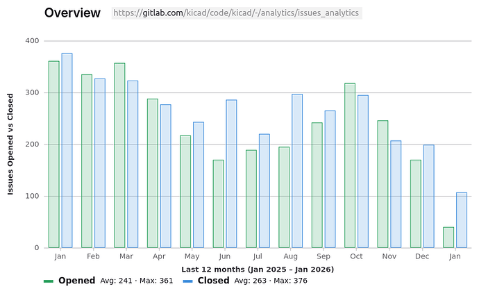

Yes, but the problem here is limited amount of manpower from the developers. For a long time (many years) there have been around 1500 open issues (many are feature requests) for KiCad on gitlab. On average, 263 issues got closed each month last year, but new issues are created almost as fast.
Issue Analytics · KiCad / KiCad Source Code / kicad · GitLab

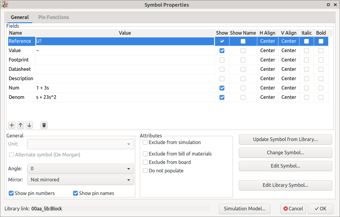

I guess this would be fairly easy to implement in KiCad / ngSpice. The value field of a resistor (capacitor etc) is already both visible, editable and used by the simulator, and I’ve also seen formula’s entered in symbol fields that are used by the simulator.

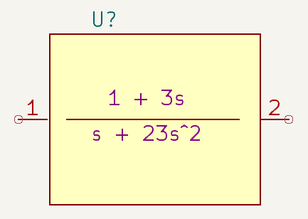

I just did a little test by creating a “block” schematic symbol.
In the symbol properties, I added two fields to this symbol. One for the Numerator, and one for the Denominator. This is all standard KiCad stuff. Both the Numerator and Denominator can be edited just like any other normal custom field. I guess that adding a model so these values are used in an ngSpice simulation is also pretty straight forward, but that is still a bit voodoo to me.
Using two fields for a separate Numerator and Denominator will cover most of the cases used in controllers, and I like the simplicity of doing it this way of using standard KiCad constructs.
One thing that is “missing” is that in KiCad, symbols are fixed size, while in software that is made for such diagrams, the boxes normally scale with the size of the formula.
More complicated blocks can be made by using the Hierarchical sheet system in KiCad. If this all works in KiCad, then I would rather do such diagrams in KiCad myself, then go though the learning curve of another program.
