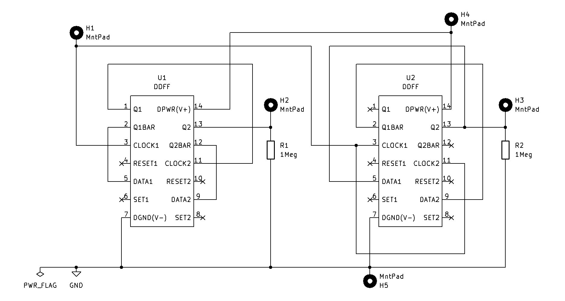

In my initial foray into digial simulations, I’ve tried several approaches to adding a CD4013 model to an existing symbol, modifying an existing symbol, creating a lib file etc. etc. I’ve wrangled with code and settings. I’ve put the time in and failed repeatedly. So I think I need to start over, and learn how it should be done.
I’m a relatively new user (Hi everyone) so there is that. I’ve been successful at simulating a variety circuits with opamps and comparators, including factory models etc. But transitioning to digital, even simple components has me stymied. I’ve been at it for a few days and I’m near my wits end.
The ask is a ready resource for a CD4013 flip flop, either multi-unit or a stand-alone single, from a source that has made it work. Simple clear instructions would help. I’m fine with “look here” or “try this” but please know my circumstances are unusual. Ordinary tasks take me longer that most and my stamina is also limited. I’ve little patience left to pioneer or engineer a solution.

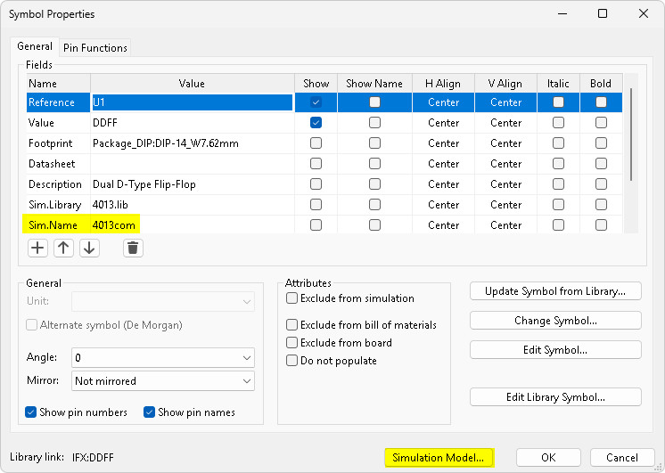

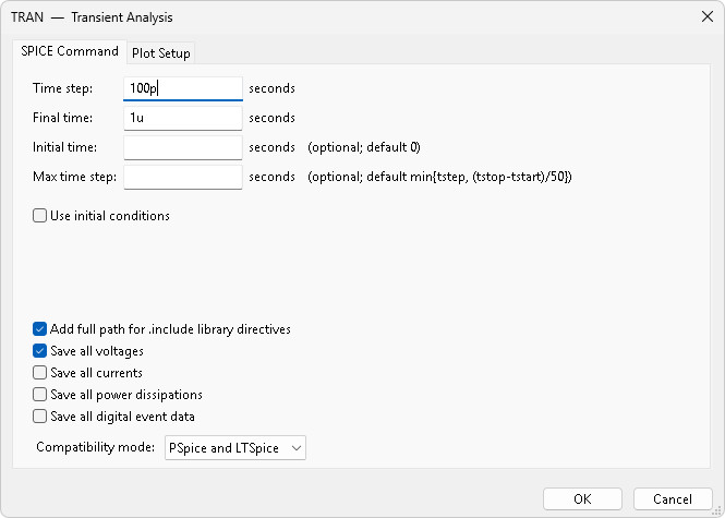

Attach this model to your symbol. To run this model, the compatibility mode in
Inspect–>Simulator–>New Analysis Tab–>Compatibility Mode
has to be set to PSpice and LTSpice.

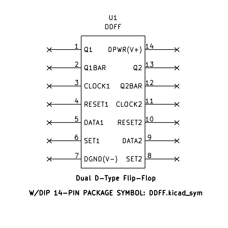

If the symbol contains two flipflops, you have to generate an intermediate subcircuit (see KiCad Eeschema as GUI for ngspice, tutorial for setting up the simulation for an example doing this with a TL072 dual opamp).
