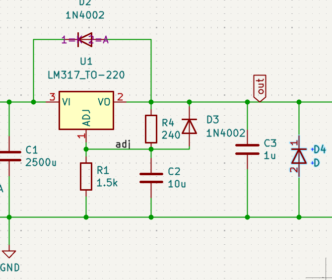

There is a LM317 power supply in the KiCad simulation sub-folder. It includes 1N4002.lib which protects the LM317. I added D4 which is just symbolic. That works as expected. However, I still need an accurate model for the 1N4148.

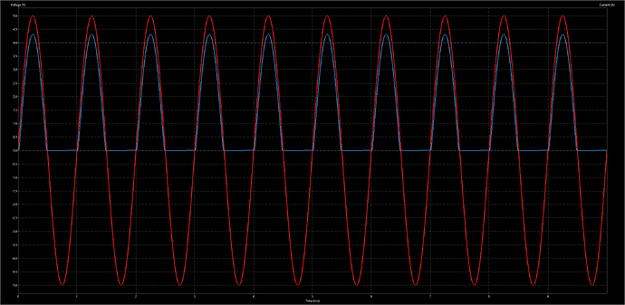

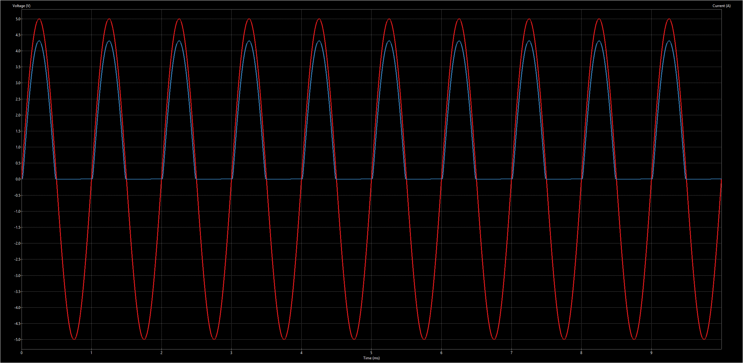

The 4148 is a very common diode and lots of vendors have published their model. I tried out the Onsemi model from their website and it works as expected.
Here is a small example.
Sim4148.zip (41.8 KB)
Which gives you the following output:
