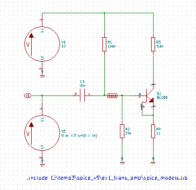

Running Kicad 5.0 RC2.
I am trying to use spice and simulate a very simple schematic , see appended file.
My problem is the transistors Q1 and Q2. How do I set a spice model to them ???
Probably the answer is “obvious”, but I have spent many hours googling around, without getting any answer that can help me.pulse.pdf (37.8 KB)

A very good question. I have spent some time looking into this, it’s been a struggle since
Anyway, here’s what I found:
For transistors and MOSFETs, even for the symbols in pspice.lib, you need to supply some additional info. If you don’t supply the info, you get an error like this:
UX Note: The error message scrolls out the window, so it is easy to miss. It just looks like it “didnt work” for no reason.
The extra info can be supplied in several ways:
  • specify an ngspice model corresponding to the symbol value in a text comment. e.g. if the value is “qnpn”, you need to specify .model qnpn npn
Here is an example using symbols from pspice.lib after example #1 in the ngspice manual (Chapter 21. Example Circuits)
You can also specify more complex models using the same method (provided the model is compatible with ngspice), e.g.
Putting ngspice directives in the schematic had the advantage of being self-contained, but can bloat the schematic.
An alternative is to create a spice “library file”, containing the corresponding directives. For example, put the following lines into a plain text file using a text editor (not a word processor) and save it somewhere:

Now you have more options. You can include the library file directly in the schematic:
OR edit the symbol and associate the model to the symbol.
  1. Place the symbols like so (all from pspice.lib):
  2. click “Edit Properties” for Q1 then “Edit Spice Model”
  3. Click “Select file” and browse to the “library file” you created earlier:
  4. Select the model from dropdown. (You don’t have to use the same model as the symbol value)
  5. The symbol Q1 properties should now look like this. Note: the spice properties now override the “Value” field. For transistors, “Spice_Primitive” must be “Q”.
Over time, you will likely build up your own collection of ngspice models in your spice library file.
Note: examples tested with kicad Version: (5.0.0-rc2-dev-266-gbad462a22), debug build KICAD_SPICE=ON
Finally, here is a sample project as complete and simple as I can make it: ex1_trans_amp.zip (1.7 KB)
