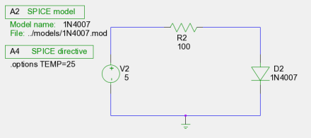

DIODE MODEL
.MODEL 1N4007 D(IS=76.9p RS=42.0m BV=1.00k IBV=5.00u CJO=26.5p M=0.333 N=1.45 TT=4.32u)
Circuit Simulation in GNU/Linux – Lets begin! | Ashwith
LINK
