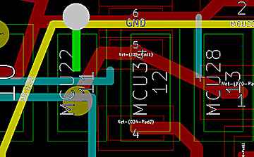

I’ve another example here where optimisation could be possible (and I don’t know it).
Layer 1: red (front),
Layer 2: yellow
Layer 3: purple (not shown)
Layer 4: green (back)
The MCU22 track comes in an down, then has a micro-via to the top layer, then a hole-through to the bottom layer where a track leads to the green MCU22 pad. Because space is a premium there is another pad underneath that going from Layer 3 to Layer 3.
Is it possible to join the micro and standard via to go from layer 2 to 4 rather than up to the surface and down?

Rene -> but how?
How do you route from Layer 1 to 3 without using a blind?
If you have a GND plane, why is there a yellow GND track?
Why don’t you go upwards from pad #11 on the back, place a via (1-4) and connect the track on layer 2 to it?
Just push the front tracks a bit to the left/up…
Yes, it is typical for blind/buried/micro vias to increase the cost aprox. 4x. Going from 4 to 6 layers would be more cost effective.
That is totally untrue. A via that is not blind or buried is a through-hole via. A though-hole via passes through through the board, it passes through all layers and can be connected to from all layers. So your MCU22 track on layer 2 can connect directly to the through-hole via.
Well a normal via can connect all layers at once. (Buried vias have the added benefit of allowing you to not disturb copper on layers that are outside of your affected layers.)
So a normal via is like a trough hole pad in this case. The drill goes through all layers, the complete inner surface of the hole is made conductive. Connections are defined by where you have copper touching the drill hole.
And are you sure your fab can make a buried via from 1 to 3? Normally buried vias are only available between a limited set of layer pairs. (1 to 3 might need depth controlled drilling which adds to cost.)
1.21Gigawatts -> perfect, that’s the bit I was missing. Right!
Joan_Sparky -> pushing the tracks up high enough was the original reason. It may be come possible with smaller via’s and I’m rejigging.
The yellow isn’t ground, there’s a red pad underneath it. Red is being used to supply it due to green being used on the rear for the bluetooth module.

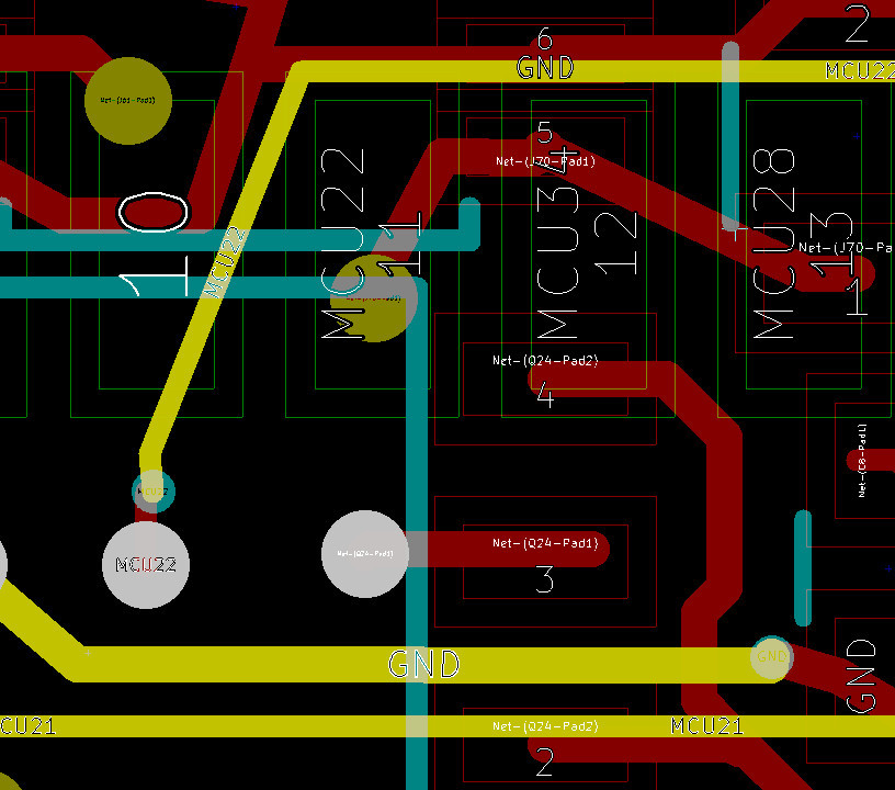

I’m pretty sure @Joan_Sparky is referring to the yellow track near the bottom of the image labelled “GND” just above the one labelled “MCU21”.

1.21 -> I think he’s referring to MCU32/12 pad as that relates to the image he posted
