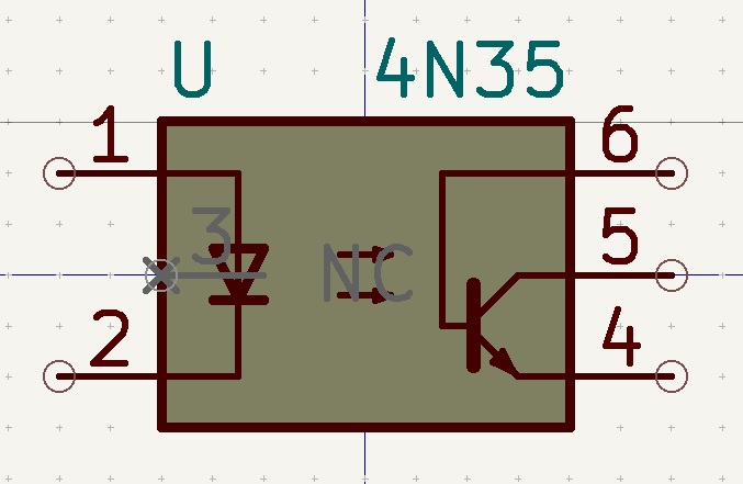

Eeschema not correctly building netlist 6 pin optocoupler
KiCAD V9.04, symbol used CNY17-1 and 4N35
This is similar to prior forum post.
I’ve now replicated it with both 4N35 and CNY17-1 optocouplers. I discovered the problem trying to use ngspice (via KiCAD)
KiCAD example files are zipped and attached.
THIS IS AN EXAMPLE THAT DEMONSTRATES THE PROBLM. E.g. yes I know that U2 seems to have Anode & Cathode reverse biased!

NOTE the “unconnected-U1-NC-Pad3” that’s the NC that is built into both the 4N35 and CNY17-1 schematic symbol.
4N35 schematic symbol:
4N35_symbol

Have you set the schematic pin number to model pin number map in the symbol properties?
The model order is SUBCKT BJT_10mA A K C E. Which is not the order of the symbol pins.

If the problem was only that the pins of the collector and emitter were reversed - I’d edit the spice model to fix that… but the problem is Eeschema incorrectly creates a netlist using the internally “unconnected” pin 3 and frequently skips the emitter.
It still sounds like you need to edit the pin mapping in the simulation model properties of the symbol. That’s how you adjust the mapping of pins in the KiCad symbol to the spice model. Obviously all the different pinouts in the world can’t map to one model file.

Thanks, I’d looked at remapping pins, but one of the points is that even with the symbol foot print marking pin three as “NC” internally, the netlist built ignored that and still mapped pins sequentially.
My point is that the netlist build should skip over pins that that have the internal pins marked as “NC”. It should have skipped on to the next pin 4, which would have resulted in the mapping of pin 4 to the collector and pin 5 to the emitter.
Both of those are piece of cake to fix in the remapping of pins.
Since this question has popped up once before, I’ll post the screen shots so future users that query looking for corrections can easily spot the pin map.
But again, this is like mapping a tab for a TO-220 part as one of the electrical pins, even though the tab might have been isolated internally and is only there for a thermal connection. If marked internally as NC, it should be skipped when the initial pin mapping for spice simulations are done.
You can open a feature request for skipping NC pins in the initial mapping if you like. May be a handy QoL thing when you have a part with NC pins.
But you do still need to pay attention to the mapping because even if you skip the NC pin the symbol pin order is AKEC(B), but the model is AKCE.
