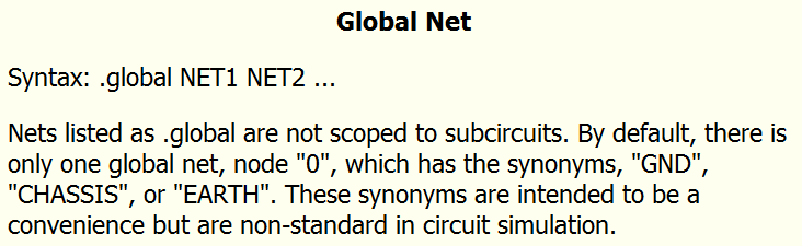

As far as I’m aware, 0 conventionally refers to the global ground node in SPICE programs. So each time you see a 0 in the netlist, that’s ground. GND is also common but 0 is more standard.
This quote is from QSPICE, and that’s a program made by the same author of LTspice.
Inside of ngspice GND will be translated to 0.
