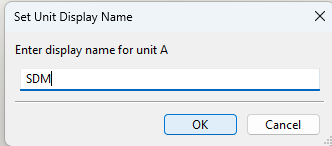

Hi ML9104, I can change the Unit names in the Symbol Editor GUI, so is this feature missing in the Python interface?
Symbol Editor:
Edit / Set Unit display names
In the library the unit_name is mentioned directly below the symbol:

However, the scheenshot you posted has the title: Set Unit Display Name. To me that suggests this is a string that is stored in a separate entity, and not the unit “name” itself.
Euhm no.

I’m guessing this Set Unit Display Name is new in KiCad V9, and as a result, it’s quite possible it’s not being used very much yet.
Yes.
I did not find any way to add the unit names, so i added a text on each Unit:
so for the selection it is still “A” to “AA” but at least in the schematic the Unit and IOBank information is visible.
You wouldn’t have been able to display the Unit Display Name in the schematic anyway. As investigation in the other topic showed it’s only for the dropdowns, at the moment anyway.
