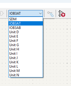

What is / was the intention of the “Unit Display Name” I can set for every unit of a multi unit symbol?
I would like to see it in the schematic instead of the automatic appendix.

I think the docs are pretty clear.
Schematic Editor | 9.0 | English | Documentation | KiCad
To add additional units to a symbol, set the Number of Units property to the appropriate number in the Symbol Properties dialog. By default, symbol units are named
Unit A
,Unit B
, etc., but you can set an arbitrary name for the current unit using Edit → Set Unit Display Name….
Here I have renamed unit G of a 74LS04 to POWER.

That’s not surprising, because the default names A B C… are also not used but the settings in Schematic Setup → General → Formatting → Symbol unit notation
Therefore I wonder why there is an option to change the unit name, which doesn’t show up.
I’m curious about this one too. Perhaps it’s a rudiment?
It affects the dropdowns when editing the symbol in the schematic. The right mouse button > Symbol Unit shows POWER instead of G, and also in the Unit chooser for the properties.
The unit_name property doesn’t seem to be made available for display. Maybe that’s for later.

I’m dealing with FPGAs, and working on bringing the Altera Agilex 5 Family into Kicad. The device has about 1500 Pins and is split into up to 15 Units. Here it would be really helpful if I do not have to place UnitA to UnitL, but can place the Unit “SDM”, “HPS”, “IOBank3A”, “PWR”…
The Example with the 74LS04 doesn’t make sense for the Unit topic, but for the big multi symbol devices, it is very usefull!!
