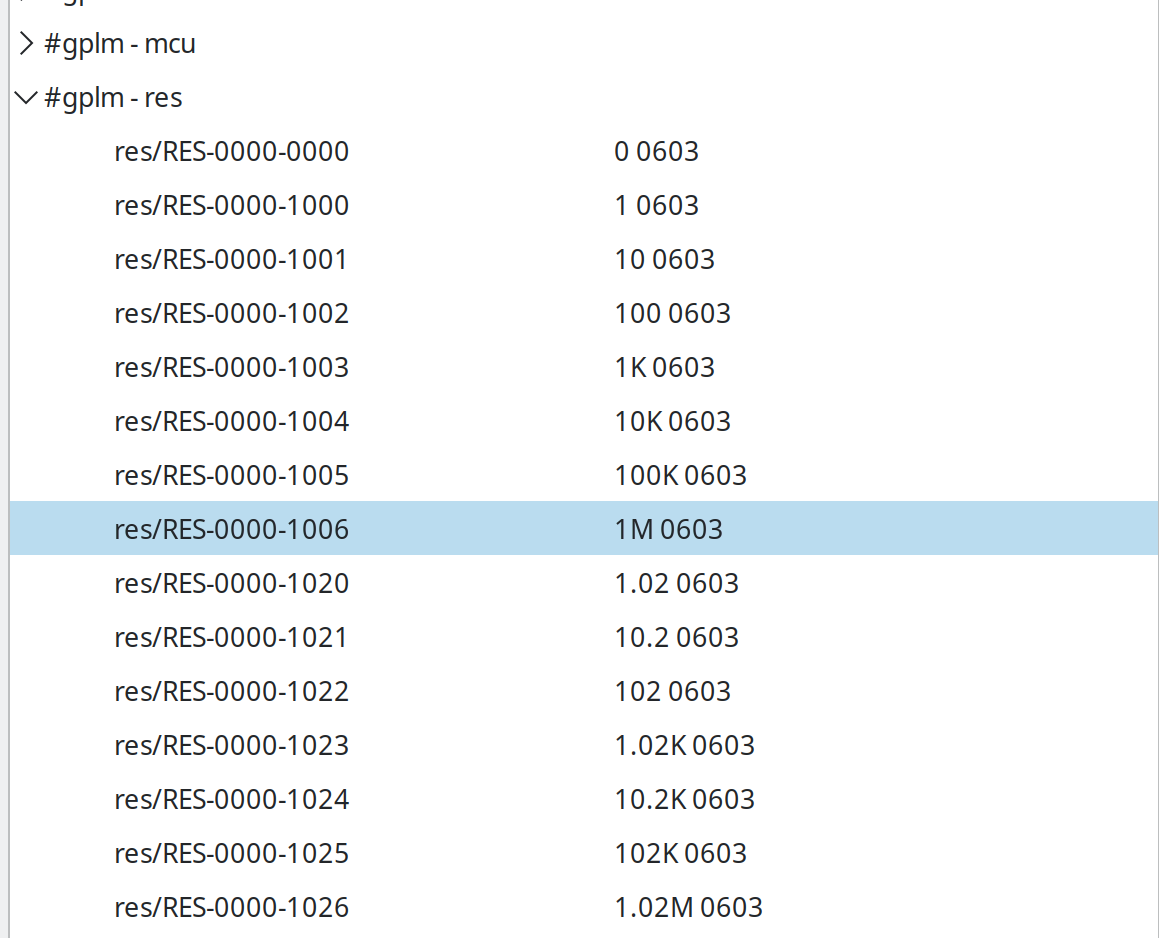

I just used Claude Code (running in a Linux terminal) to populate standard resistor series in the GitPLM parts library.
Before, there was a mixture of different manufacturers for 0603/0402 resistors. We decided to standardize on Yageo (something stocked fairly well worldwide) and populate all the E96 values while we were at it.
I started by making a doc change in the README:
### Preferred manufacturers
- Yageo is the preferred manufacturer for standard thick-film 1% `0402` `0603`
  etc. resistor series (`RES-0000`, `RES-0001`). All `E96` values are populated
  for these series.
I then ran the /plan command in my doc-driven-developmentplugin. This generated a plan file, which I tweaked slightly.
Then I ran the /implement command (from the above plugin), and Claude did all the work. It generated several Python scripts to generate the part entries. The resulting csv file looks good and works well in KiCad:
This is another example of how Claude Code is not just for software developers. The above implementation ran without any intervention on my part.
