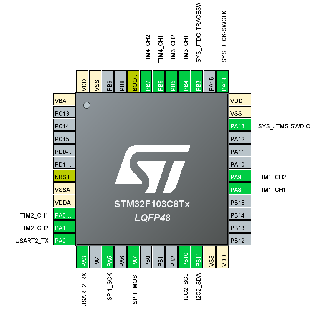

Hi all,

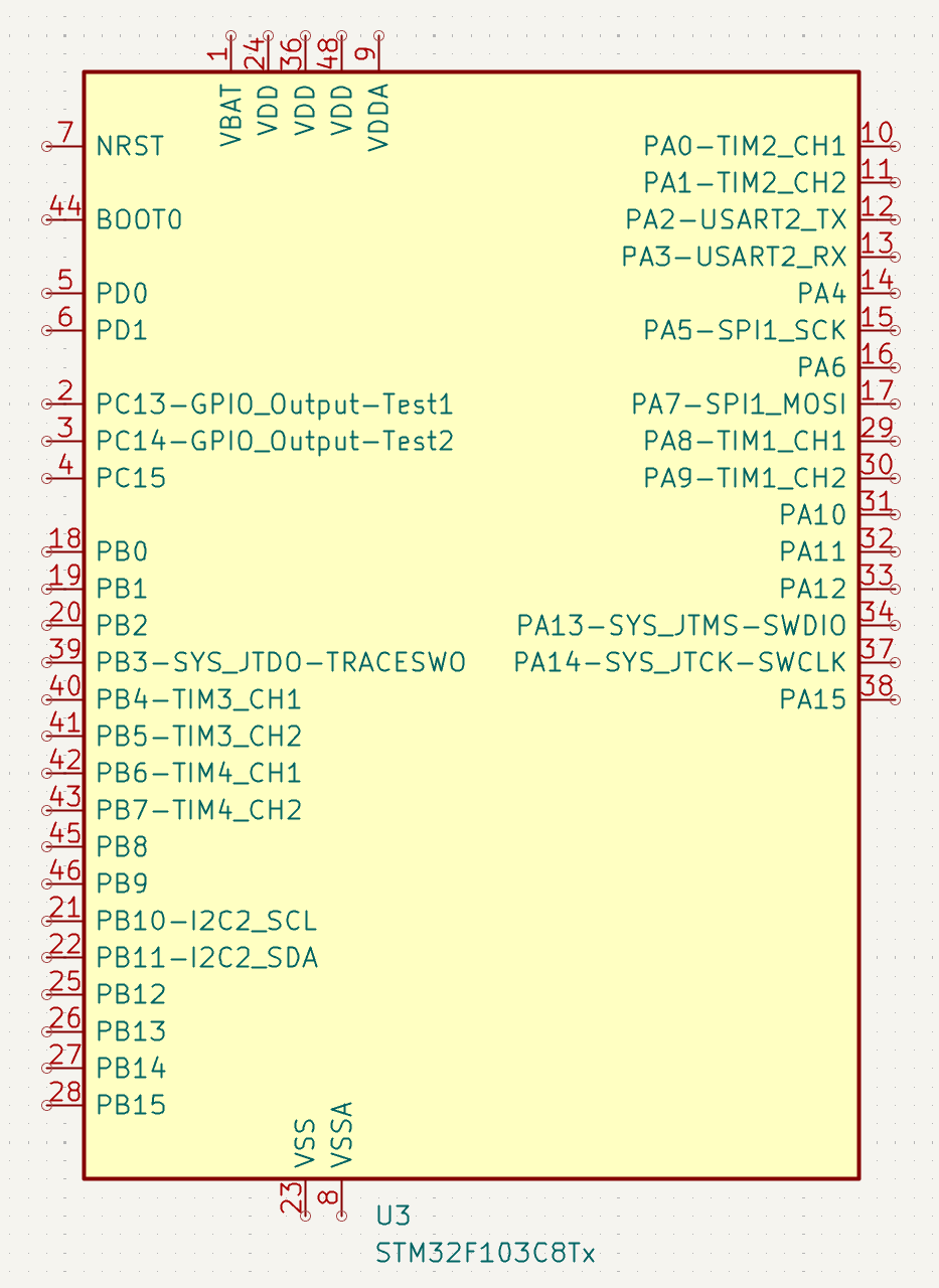

when working with STM32CubeIDE you get pin assignments like this:
In order to use this in the schematics, you have to manually adapt the STM32 symbol
and enter labels for all components. This is a tedious and error-prone process - notice how the CubeIDE graphic does not show pin numbers (you have to count or mouse-over), also the KiCad symbol has the pins in a different order. The alternate pin functions are brillant though!
Has anyone attempted to generate a symbol from a STM32Cube assignment? It seems possible to export those

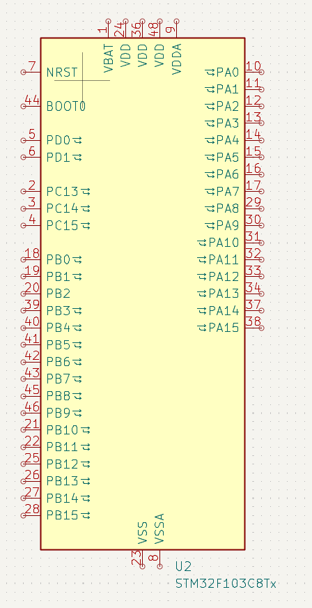

OK just tried Claude Haiku 4.5 (in VSCode Github Copilot Agent mode). I gave Claude Haiku a go as it costs 1/3 of Claude Sonnet (and is said to be much faster too).
I told it to extract the symbol from the STM32F1 library and delete all alternate functions.
Then I told it to copy the pin modes and labels from the CSV file. Interestingly Haiku did not do this by itself (as Sonnet probably would have done), but created a Python script to import the changes. It took some discussion, but finally did what I wanted.

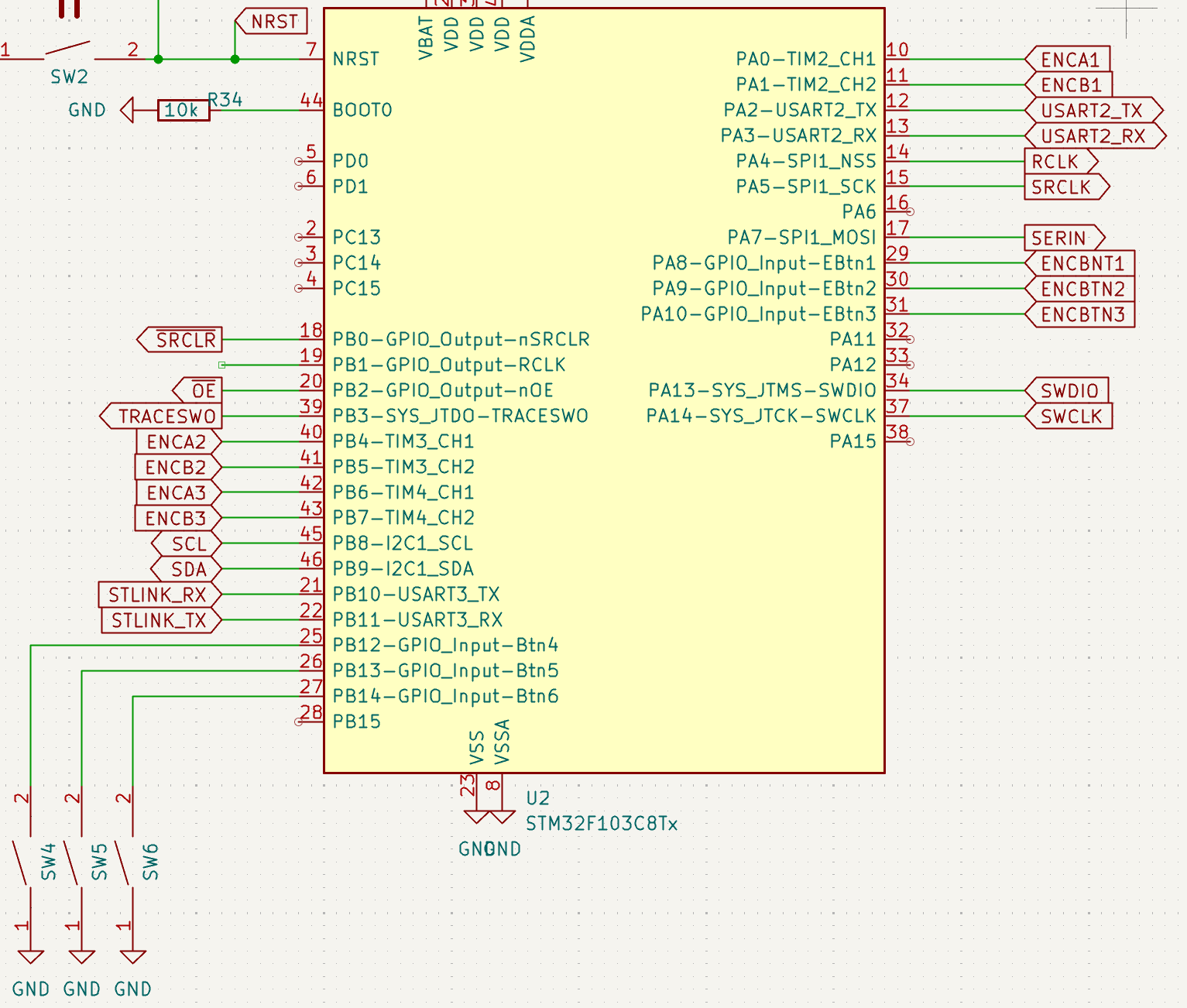

The result is pretty decent already. I had to widen the symbol manually to make the names fit.
Now you could discuss whether PB3-SYS_JTDO-TRACESWO should be PB3-TRACESWO or TRACESWO (as I don’t use JTAG but SWD). The nice thing with Claude is that you can simply tell it what to do and it will fix the code - instead of digging through cryptic regexes. I have not looked more than a few seconds on the python script - it seems to work fine, so why bother.
Pretty amazing AI stuff. Best of all: I could have coded all that by myself. But it would have been gruelling, tedious and boring work. Just like we used to code for the past decades. Now it’s a few copilot prompts.

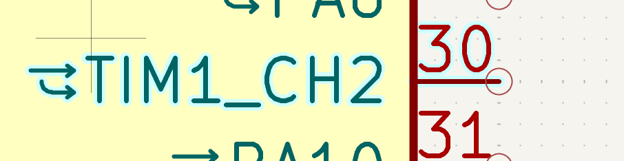

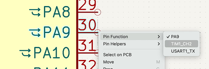

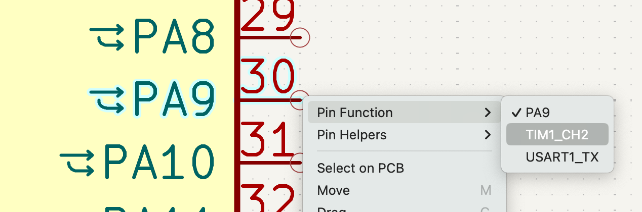

Rightclick on the pin and choose the alternate functions: PA9 for example, see the pictures below.
Works in most newer Symbols.
Cheers
It’s not about alternate functions. I know how this works.

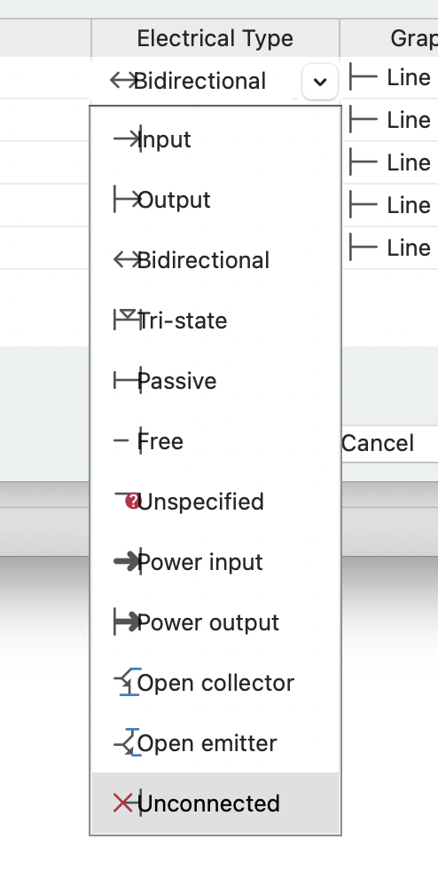

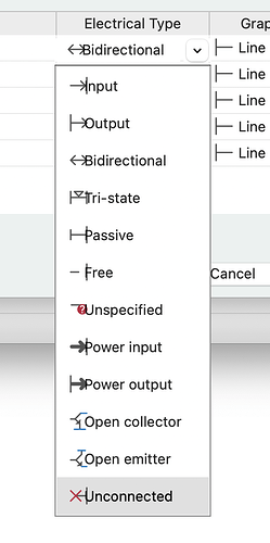

But with the alternate functions you would have the correct electrical type (Input/Output/etc.) and that would be important for the DRC.
In your python script I didn’t see that the “Electrical Type” is modified.
Maybe you have to ask the KI again !
IMO the “input/output” classification is far too limited to be of any practial use. I always use the DRC in PCB, but never with schematics (nor do I know anyone who does).
Can you explain how you use the ERC? What types of designs do you do?
You can have much more than input/output, see screen-shoot. (thats why i wrote (Input/Output/etc.) in my post.
With correct defines in the symbols and correct ERC matrix you can avoid errors in your design.
Documentation Schematic Editor | 9.0 | English | Documentation | KiCad is good and should help you.

It only works for GPIO. The two timer channels are inputs in encoder mode, but marked as I/O.
The SPI signals are master transmit only so would be outputs, but also I/O. Same with UART RX/TX.
Yes, Claude could modify the script, but I doubt it would be of much help.
Well, modifying the pinout after it was imported would kind of defeat the purpose… The whole point of the excercise was keeping designs in CubeMX and KiCad in sync.
But I’m sure one could keep those alternates. Of course the converter script then would have to select the correct alternative (like the SPI4_SCK of all possible alternatives). I wonder if the wording used in CubeMX and the KiCad library is consistent.
Also, when using the predefined alternates, what about the user labels?
I added the original port number (which is somewhat informative even if you configured it to an alternate function) and the user label. As always those things are a matter of taste, balancing between cluttering the schematic and losing information.
Actually the labels would be useful in your schematic. How do you make sure that MCU_5V_EN is an PD6 and not PD7? If you have assigned it in CubeMX, it generates the definitions in main.h - wouldn’t it be nice to have those visible in the schematic? That was my thought here, for example PA8 has the user label EBtn1 assigned and is connected to net ENCBTN1.

Ah yes, I see your point. I still like to be able to click on the pin to see the alternatives. And I prefer to allow them to diverge - they could well have different design lifecycles and I don’t necessarily consider the CubeMX view of the world as correct. But I see your point - if you treat the ioc file as the single source of the truth, that eliminates a manual step and one source of error.

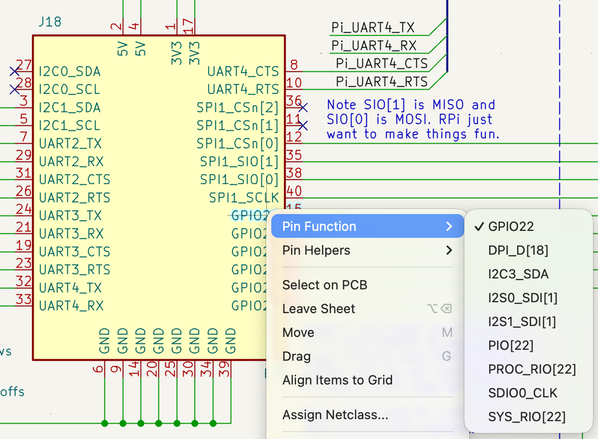

Now you need to do it for all the other MCU’s as well :wink: I created a RPi5 symbol with alternate function pins (including electrical type) using a sed script similar to your Python script. So I guess I’m biased to think of those alternative functions as standalone useful.

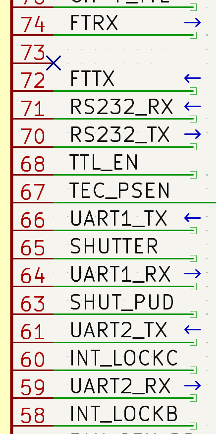

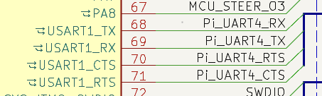

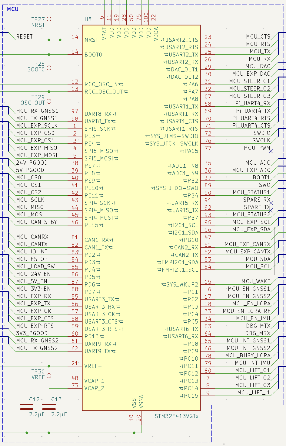

Tell me about it. Can you believe one of these is correct and one isn’t? Every year I swear is my last making TX/RX swap mistakes. Every year I’m mistaken.

You’ll love this:
(STM32G4)

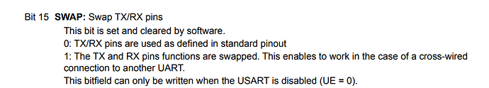

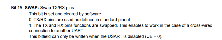

Oh I make sure to only ever make that mistake on USARTs that do not support SWAP.
And RTS / CTS? Those are swapped too in the second screenshot.
Nope, that’s the correct one! Netnames are from the perspective of the UART on the other end. That’s what my “Pi_” naming convention was supposed to remind me of, and it did. Alas, I changed my mind half way through for the “EXP” UART…

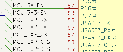

Ha! Murphy lives. I’ve taken to using arrows next to a signal name to help keep me straight. The default KiCad font set supports extended Alt-XX characters like arrows.
Wait…? Did not a few post above someone advertise the input/output tagging of pins together with ERC as the holy grail of finding connection bugs?
How come something stone age as a left-right arrow is necessary when we have the glory of ERC?

In your first picture you show a chip image from CubeMx. Which is nice. KiCad should copy that with names. An other option is? logical groups like KiCad symbols. Those two should be options in SCH symbol.
Those arrows are good.in TX/RX, by the way
