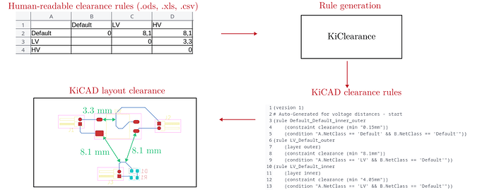

i’d like to announce KiClearance version 0.2.0 !
See also previous post
KiClearance auto-generates the clearance distance rules for your KiCad layout.
We have added some new features
  • the initial table is generated out of the given kicad file (this step has to be done before manually)
  • the rules are are less in total, so the routing is faster as KiCad has to deal with less rules then before
New version is available on pypi and can be installed as usual in your python virtual environment, e.g. pip install kiclearance
Code, Docs and usage: GitHub - upb-lea/KiClearance: Generate clearance rules for KiCAD by a human-readable easy-to-use table.
grafik

Trying to add such a feature (detect more than one Netclass to a single net) to KiClearance, i am questioning myself how to get the information.
  • .kicad_sch file contains just the graphical coordinates of all the elements, also from netclasses, but no real usable information which net is linked to which netclass
  • kicad_pcb file contains no net class information at all
  • kicad_pro contains general net class information, but not what class is linked to a net
Do you have any suggestion how to get this information with a 3rd party script, as KiClearance is?
No solution from me (only user, no real programmer apart from microcontroller stuff).
Maybe some other @KiCad_Developers can help?
i found out, that the linked netclasses to nets can be found in .kicad_pro file, and so i can check for multiple net classes are assigned to a single net.
I have updated the KiClearance tool accoringly, an error is rised in this case.
