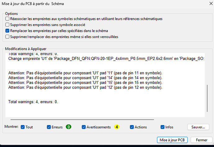

I can see this footprint, it’s missing the W but it looks similar. When I update the schematic I have 4 warnings but no errors. I think it’s not very important this message, Right ?
I must complete because I am only allowed one image per post
What does that mean Pas d’équipotentielle pour le composant ‘U1’ pad…
Can I continue safely ?
But in PCB I have 9 errors :

You have selected a 20 pin part, not SOIC-8
Look carefully at your Value line. It’s for the ATtiny85-20M. As it turns out this is the QFN package version with 20 pins. Therefore you should be looking for a QFN-20 footprint. What did I tell you above about looking at the datasheet for the chip you have (or are going to buy)?

Probably the video is giving me false information. I uploaded the new fingerprint and now it looks correct.
Thank you all and have a good evening!
Your library and value still indicate the M suffix, which is QFN-20 not SOIC-8. That’s why you got the errors about missing pins. You should check your schematic symbol.
Pin 8 on your footprint is connected to GND net - this is correct on a QFN-20, but the SOIC variant should have GND on pin 4. Don’t ignore warnings!
