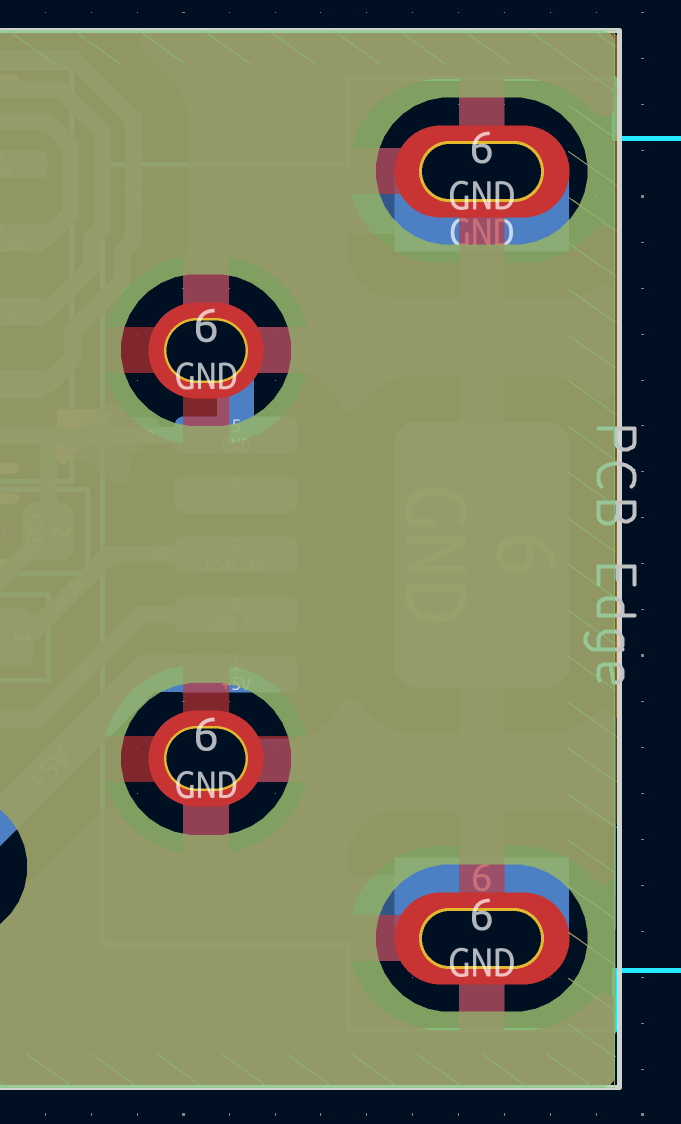

Through hole pads aren't connected to inner layer
I’ve got a micro usb connector with through hole connections for the ground shield:
And I’ve got the same symptom as here Zone fill fails to connect to some through hole pin pads, not others - #2 by mf_ibfeew but I don’t have tight tolerances
My GND inner layer (green) is not connected to the GND pins of the through hole part. You can see the purple (red and blue) thermal reliefs of the pad on the top and bottom layers.
The fill has the GND net assigned, and the same zone property settings as the GND plane as the blue/red outer layers. My GND vias are properly connected to the green inner layer, so I’m pretty sure its not a net problem…
What haven’t I set up properly?
Thanks
Andrew

Can you paste your full version info here please, you can get it from KiCad > Help > About KiCad > Copy Version Info
Secondly,
did you press B to refill the zones after you set the zone to the GND net ?
Thirdly - what is your inner layer zone fill net?
Yes, refilling the zones has no effect
The inner layer, which is set as a Power Plane, and called GND.Cu, has a fill zone associated with the GND net.
If i manually add traces from the through-holes to the GND fill, DRC doesn’t comlain (as in, it doesnt complain there are nets connected that shouldnt be). Similarly the GND vias are properly connected to the GND fill/inner layer.

Can you share the project?
What layer is selected in your first screenshot?
Double check the net names. For example, KiCad accepts (trailing) spaces in net names, and this effectively turns it into a different net.
How extremely odd

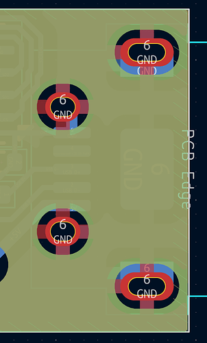

I cloned my project files in order to create a minimal repro to share here, and the problem had gone!
I switched back to my original copy and it works there now too…
I’ve made no changes. Literally been for dinner and put the kids to bed since my first post, not touched the PC!
I’m sure the internet won’t believe me :frowning:
Anyway, thanks all for your time.
:wink: your secret is safe with us. Glad to hear it’s fixed, that is the main thing.
Well, I’m nervous now.
I only happened to notice by chance just as I was about to send it to the manufacturer.
Scared this is some bug that will recurr.
Can’t repro it now though obviously

Looks like someone else is seeing the same problem / bug.
The problem appearing only after the layer count is increased may be an important hint, but I’m still on KiCad V8 and can’t verify it myself.
So OP from this thread added to the other thread:
It seems plausible this is a bug that only shows itself just after layer count is increased, but does not persist after a restart of KiCad. Can this be verified / reproduced?
Ill test it later tonight
