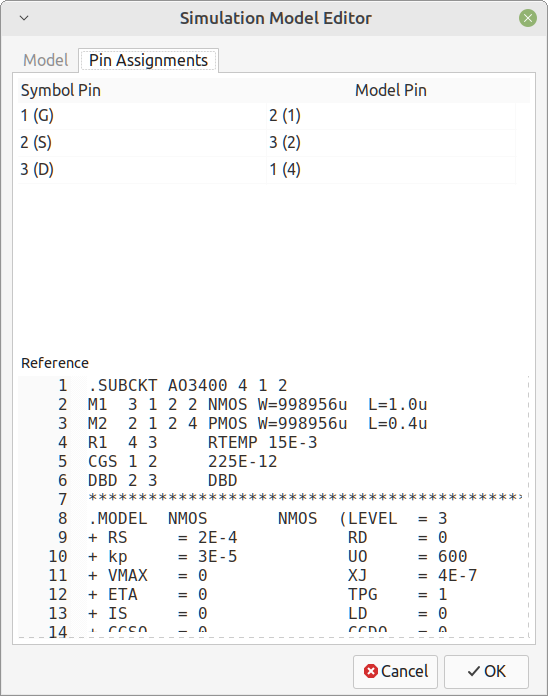

then it looks like it expects pin numbers 4, 1 and 2. Problems with pin numbers are quite common during addition of spice models to KiCad symbols. KiCad’s pin numbers are based on the footprint pads, while spice does not use “pin” numbers, but “node numbers”. These numbers are quite like a “net” in KiCad. These numbers are often quite random, or follow some unknown rules.
KiCad does have the ability to map the pin numbering of symbols to the spice node numbers, but you have to enter this manually. There is a Pin Assignments tab in the Spice Model part of the symbol properties.

With that info, the total pin mapping becomes:

This is really not the best thing:
Especially as a beginner, I have no idea what 2 and 1 means in “2 (1)”, which one is the pin and which one is the node in model .
Probably a better naming would be:
.SUBCKT AO3400 4D 1G 2S
I’ll try to change the model source that way, and submit a PR to the model’s author.
It is also not clear why would anybody use pin number 4, when pin number 3 is not used? The official datasheets of these devices usually do not mention pins by their numbers, and the default package Package_TO_SOT_SMD:SOT-23 also does not have pin 4; only 1,2,3.
In
.SUBCKT AO3400 4 1 2
the node names 4 1 2 are used inside of the subcircuit to connect the internal devices. Instead of numbers one could use letters or a combination of both.
To the outside, when calling the subcircuit, the node names are not of impartance, but the sequence of the nodes, their position in the list is.
As Paul has noted, the position numbers (from left to right) 1, 2, 3 correspond to the node names 4 1 2 and correspond to the device terminals drain, gate, and source.
These position do not correspond to the symbol pin numbers, which stem from the transistor package, and which are determining the outside connections.
The pin assignment has the task to translate between symbol and model pins.
The symbol column on the left is fixed. The user has to shift the nodes in the list of model pin on the right., so that the functions (drain, gate, source) match.
.“2 (1)” does then mean: position “2”, with model node name “1”. Position 2 is the gate.
