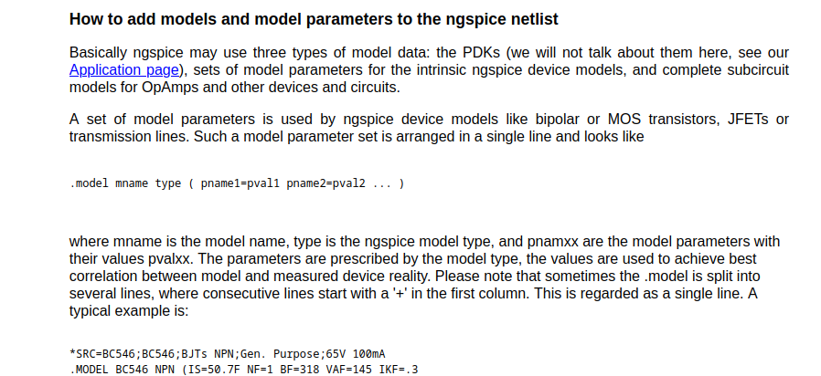

Anyway, the information on how to add the models to ngspice is only three redirects aware (after finding the tutorial).
… which take us to
And voila!
Oops! Still a little mysterious, and nothing about where to put the models listed on the previous page. So, there I was stuck.
I guess I still haven’t seen where the information is on what to do with those zip files on any of those pages. Perhaps I just perused a little too fast. (There is a lot of information there and not a lot of headings or a TOC)
It seems to me the information about what to do with zip files might be more clear if spelled out right there where it says (paraphrasing) here are some collections, before it begins the list.
But thank you, it is an impressive effort to make all of this available. I’ll probably be up an running in a short while.

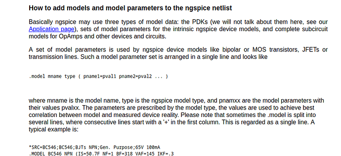

No need to go there. the section about the BC546.lib model (even shown in your screenshot) should have been enough I guess. Right after the “copy into your project directory” you can read how to add the model to the symbol.
Okay, I’ll look again. Thanks.
Maybe a standalone section, using third party model files in eeschema (kicad).
And a TOC
Aha! I see it. Just one line further. Thank you.
