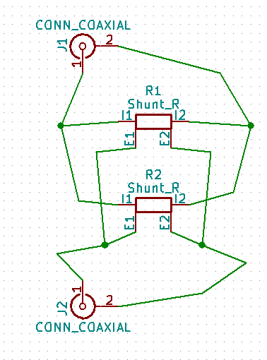

Hi, I’m a student who is new to both PCB design and KiCad, I’ve spent a good while looking through some tutorials and been doing fine in my work so far. Now I’ve got a new mini-project going and my goal is to produce a prototype PCB for some testing of a couple of resistors. I want to use the method of 4-terminal sensing, and have therefore drawn a schematic with 2 N-type PCB mounts.
Now, the problem I’m having is that, when I start PCBnew and read my netlist, all the footprints load in correctly but not all connections are drawn. One of the coaxial connectors gets left haning in the air. Like this. (Not sure how to attach pictures)
Also, here is a picture over the schematic in Eeschema. I’ve already tried moving around the joints with “G” to check that everything is indeed connected.
Any help would be appreciated!

Have you tried to generate a new netlist? The schematic looks fine, but in the layout it seems E1 and I1 are connected, and the same for E2 and I2.

I tried this too, but as you are saying E1 and I1 are connected, wich is how it should be (at least in my head, maybe this is not how you do things in pcb design though?).
For reference here is the resistor I want to place. And as the internal schematic suggest both of the legs are connected from “inside” the resistor.
I’ve noticed that this can indeed help in some situations, but it would seem that in this case the component isn’t actually connected to the rest of the schematic, right?
Can you please grab this corner [G] and try to move it around - what happens?
I tried moving all of the corners around for you here.

That’s how a 4 wire connection is supposed to look like.
This way one has 2 wires that have a high current on them but the wires for measuring the voltage drop has only a low current on them.

Did you run an electrical rule check on your schematic? If not: run it and show what it says. (If @Joan_Sparky is correct, then you will get a message about unconnected pins.)

Yes, I did run an erc with default settings and got no errors or warnings.
Could the problem have something to do with the fact that the component “CONN_COAXIAL” only has 2 pins and the footrpint I made for the PCB-mount has 5 pads?
No, the netlist is wrong.. PCBnew is not at fault. This is some error in EEschema related code that makes the netlist.
PS: if you download the netlist file in that post up there with the _3 in the name.. can you load that in PCBnew and look if it solves the problem for you?
I think the problem might be that two pins of the symbol have the same pin number. This should not be done. (E1 and I1 currently have the pin number 1. E2 and I2 have pin number 2)
The correct way would be to give the symbol one pin number per pin. (Or to only have two pins in the symbol.)

output of the erc check of the symbol:
Duplicate pin 1 "I1" at location (-0.200, 0.000) conflicts with pin 1 "E1" at location (-0.100, 0.150).
Duplicate pin 2 "I2" at location (0.200, 0.000) conflicts with pin 2 "E2" at location (0.100, 0.150).
