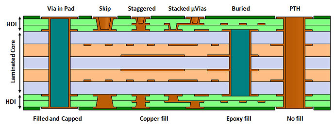

For those unfamiliar with the term, a skipped via is a special type of via that is only connected to its end layers, so a skipped via going from F.Cu to In2.Cu will never connect to In1.Cu.
Skip vias can be useful when there is not enough board space to allow regular through hole vias.

“Skip via’s” (without the “ped”) are apparently some special feature. I did a short search and read some (parts of) articles. The link below is one of the better explanations.
I also did a search through the Gerber X3 standard. It has four references to skip but all are in a different context. Maybe this is only defined in those “other” pcb manufacturing formats? As far as the Gerber standard is concerned, there is only a start and a stop layer for holes (PTH, Blind, Buried), and there is no specification on how the hole is made.
So maybe it is the same. If KiCad removes the annular rings, then the PCB manufacturer can deduce that skip vias can be used.

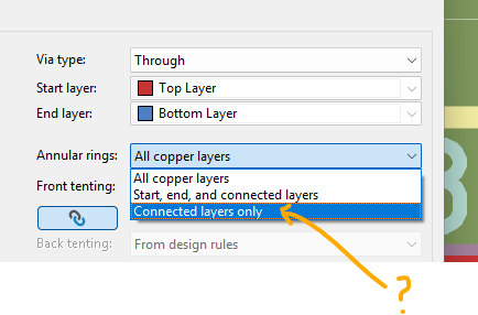

The manual disagrees with you . . .
The Annular rings setting controls which layers will have annular rings for the via.
  • When set to All copper layers, the via will have annular rings on every layer.
  • When set to Start, end, and connected layers, the via will have annular rings on its start and end layers as well as any layer with a track or zone connection to the via. Any layer without track or zone connections, other than the start and end layers, will not have an annular ring.
  • When set to Connected layers only, the via will have annular rings only on layers with a track or zone connection to the via. Any layer without track or zone connections will not have an annular ring.
It doesn’t support what OP wants.
If an intermediate layer has a GND pour, it will be “connected”.
He needs an annular setting “start and end only”.
And that is what the manual says it can do . . .
When set to Start, end, and connected layers , the via will have annular rings on its start and end layers as well as any layer with a track or zone connection to the via.
. . . the way I read it, it’s meant to do that.
NOT connected layers
Exactly, which is why I said kicad doesn’t support it.

Skip via is just a blind via that cannot connect to intermediate layers. They are faster to manufacture than stacked or staggered microvias because this technology requires fewer lamination/plating processes
