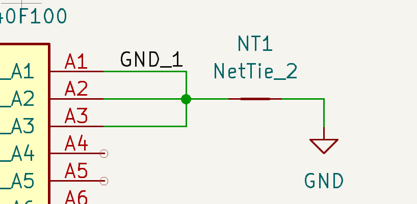

Another workaround is to use net ties, to break the net into sections. When KiCad thinks it’s a different net, it won’t connect the via’s to the zone.

If you have a large area of many pins, paulvdh’s idea of a net tie and a separate GND-like net for the In2 fill is probably the “right” way here, with the benefit also that it’s quite clear documentation that there’s an area of special GND that needs to go somewhere else before connecting to the main GND at a defined location.

The net tie in the schematic then gets marked “not on board” to avoid a schematic parity error.

Adding net ties to every single decoupling capacitor and what else needing a Gnd, would probably work in some cases, but it would also clutter the schematic in a way that would be quite undesirable in my case.
In my opinion this is purely a layout problem and as such I would be extremely hesitant to let it influence the schematics in any way.
