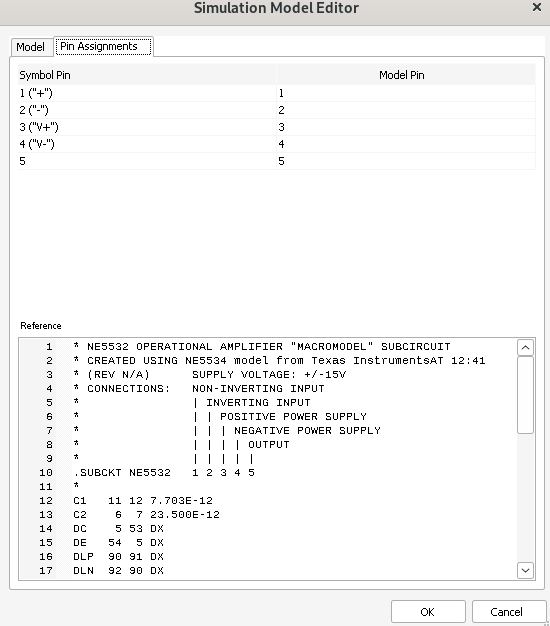

I note that this model should work with KiCAD but I’m getting the following error:
Note: Codel model file loading path is C:\users\crossover\Desktop\Test\
Background thread stopped with timeout = 0
Note: Compatibility modes selected: ps lt a
Error: Mismatch of .subckt ... .ends statements!
in file "Y:/Documents/5532.subckt
This will cause subsequent errors.
Check .ends in line number 1
Error: ngspice.dll cannot recover and awaits to be reset or detached

Your model file seems to be corrupt. It does contain the same model twice (from .subckt … to .ends).
At least your copy to this thread is defect, the model in the zip file is o.k…

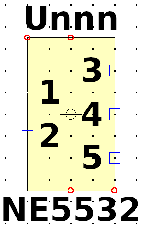

Your pin assignment between symbol and model is wrong.
This is what you need:
1 5
2 2
3 1
4 (VCC-) 4
8 (VCC+) 3
Blockquote
At least your copy to this thread is defect, the model in the zip file is o.k… Your pin assignment between symbol and model is wrong.
|1|5|
|2|2|
|3|1|
|4 (VCC-)|4|
|8 (VCC+)|3|

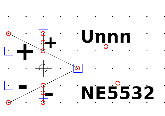

I understand the pinning of an 8-pin DIL but I’m missing something here in NGSpice. I’ve used that model this afternoon without issue in (can I say this?) LTSpice. LT Is a massive pain in the bum when creating models as I’m sure you’re away, but it does create the correct pinning which is the same I thought I’d used in KiCAD.
LT creates this mess:
Which has to be re-drawn into something a bit more like a proper amp. LT doesn’t even have a triangle primitive (yet).
I don’t fully understand from your explanation what NG is expecting. I’m reading the pins from left to right as:
1 → non inverting (pins 3 and 5 on a dual amp, 8-pin DIL)
2 → inverting (pins 2 and 6)
3 → Vcc (pin 8)
4 → Vee (pin 4)
5 → output (pins 1 and 7)
I’m obviously missing something here but for the life of me, I still can’t see the wood for the trees. I’m sure I ran earlier simulations (KiCAD 7, I didn’t do anything with v8).
