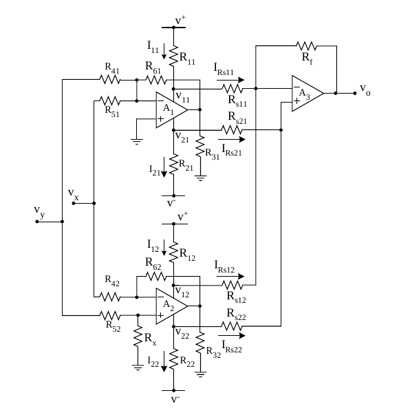

I’m trying to simulate a circuit I have found in ICCAS2005 proceedings.
This circuit runs as expected with 741 and a symetrical power supply (+/- 6V). In my case, I have to use the same circuit with a single power supply (0/5V). Thus, I’m trying to simulate with TL971 as I have a model I have tested. This model returns expected values.
Here is my schematic:

OP or TRAN simulations abort with Timestep too small error. How can I fix this issue ?

This is not a KiCad nor a ngspice issue, thus a little off-topic for this blog. However I will give an answer, if only to show that it is not a simulator problem.
By good old engineering practise: divide and conquer.
What did I do?
Use as many copies of sim_thyristors.kicad_sch as needed (command ‘save as’).
Operating point simulation fails.
Throw out the thyristor stuff: simulation still fails.
Remove all TL971 opamps (exclude from simulation): op succeeds.
Put back U5: op succeeds. The amp draws 2mA from the supply.
Put back U4 in addition: op fails (same with U6).
Throw out everything except U4 and its surroundings: op fails.
So U5 is o.k., U4 (and U6) are not.
What is the difference: the resistors in the power supply lines.
Had a look at the TL971 data sheet. It says:
ICC Supply current (per amplifier)
Unity gain, No load, (at ±2.5V): typically 2mA.
Considering the resistors R14, R15, you are running the device (and its model) completely out of spec, as it will not get its current supplied. So the simulation fails.
Thanks for your answer. Before posting here, I have bisected problem. Even with smaller values (220R for R14/R15), simulation failed (but during simulation). I know that current supply is around 2 mA for one amplifier. I’ve just tried with bigger values with 15V power supply and I have forgotten to replace these values.
