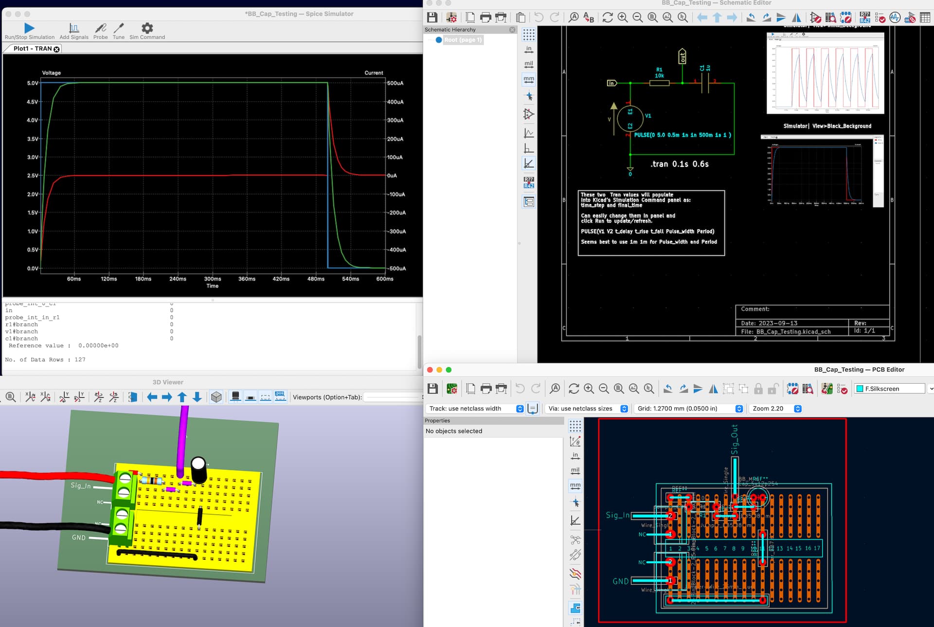

This (my way of doing it) may or, may-not help but, it can be a starting point…
What do you want to simulate? There is not much on that “Digilent Protoboard”. There are two 7 segment displays and 4 buttons. And it looks like there are some connectors which interface with the Digilent test equipment.
The schematic itself should just be drawn as any other schematic, with signal flow from left to right, and voltages from top to bottom. Both the buttons and the 7-segment led’s can be symbols from KiCad’s default libraries. For the connectors, you can make some custom connector symbols with the same texts as the signal names on the Digilent breadboard.
You can draw the breadboard in the PCB editor, similar to what BlackCoffee has shown, or keep it a bit simpler with only some outlines on a user layer, and then draw the “vertical 5-hole strips” as regular tracks and only when needed. Then you can either use “cross probing” to quickly find locations between the schematic and breadboard layout (open both the schematic and PCB editors side to side (multi monitor setup is also great for this)

As a follow-up: I often need to Tune a Circuit by using specific Cap and Resistance (Resistors and/or Pot values) and I use this Circuit… on BreadBoard then, Build and Test it
