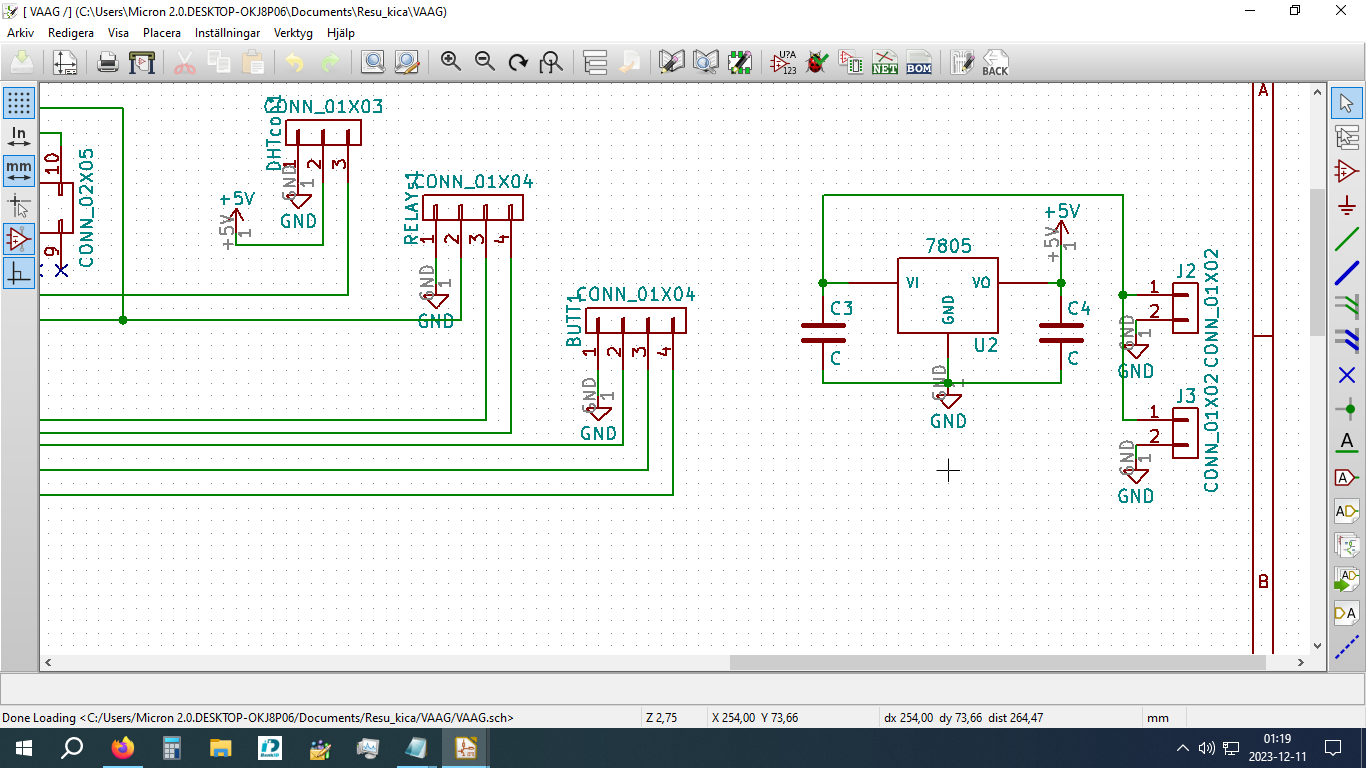

HI, Im rather new, or returning intermittent user, so have to appologize but running 4.0.7 still…
Anyway, I think my problem is trivial, but cant just get round it seems.
Have a component that, how I try it will not connect/create a net. I.e. I dont get the “white lines” in PCBnew, and checking the .sch cant find a net . Running the bugg-check, I got an arrow indicating place where not connected, fixed it , arrows and errors gone (by removing track and re-inserting, getting the hidden pad), but still not connect/net.
( Further more there is yet another place where bug-check has an arrow, but there Im not able to get the connect to take.)

Can you share the project or at least a picture of the schematic?
Mainly with the whole net you do not get the ratsnest.
This is in fact very feasible for KiCad. It does not need to be kept connected to the Internet to work. With the supplied symbol and footprint libraries one can do a lot of work without an internet connection. It’s only when upgrading software that you need to get the new packages onto the machine.
But that old machine of yours won’t cut it for current KiCad versions.
But back to your problem, you have to post more information, at least a screenshot, or better still the project files. I suspect that the symbol that you added doesn’t actually have any pins or wires, it’s just graphics so doesn’t contribute nets. But it’s all guesswork without more clues.

Of cause, its shaming trival, include screenshots;
The error arrows now gone, have regenerated net, and imported in PCBnew
I do have some other errors from unconnected tracks, which might disturb.
Which I have possibly wrongly assumed, unrelated.
Actually I have copied the .sch from a project where this part worked, then removed some
After “fixing” ;

BTW you realise that you can mirror the 7805 around the Y axis so that you don’t have to curve the Vin wire around the regulator and the digram will look better with power flowing from right to left? Naturally you’ll have to redo the wires and parts around it.

@georg In your schematic you have used a metric grid. That does not work properly in KiCad.
Repairing this in KiCad V4 is a nuisance. You have to:
  1. Set your grid to 50mils
  2. Drag each of the symbols around a bit so they snap to the new grid.
  3. Fix connectivity.
In newer KiCad versions this has been made very much easier. In KiCad V7 you can simply:
  1. Set the grid to 50 mils.
  2. Select everything by dragging a box around the schematic.
  3. Right click and select Align elements to grid from the popup menu.
Yet another change in newer Kicad versions, is that you do not have to create a netlist anymore to inteface between the schematic and PCB editors. Instead you can just use: Schematic Editor / Tools / Update PCB from Schematic [F8]

Hi ! Right, but I just turned it, since I hade it placed on the “right side” of the PCB, and wanted the “in” to be on the right side where the connectors were placed. So on the net it seems strange, but on the PCB its natural… (why I wanted it on the right side is another question … possibly arabic)
Mm grid ! Wow thanks paul. So since Iv started over and not done placement/tracks, that was good.
And yes, would probably gain on making an environment upgrade, possibly buy some new Hw, I have a win10 machine, but I really hate that os. Been thinking of linux… on the other hand… time tends to just dissappear…
You didn’t get it. You don’t move the connectors. All you do is mirror the voltage regulator symbol around the Y-axis so that Vin pin is on the right and Vout pin is on the left. Then you don’t have to route the Vin wire around the 7805 symbol.
