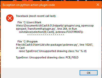

I ran across this thread while trying to find a way to scale my logo on a PCB silkscreen. So I installed the Transformit plugin and selected my logo, then clicked on the plugin, changed the scale to 85% and clicked Enter and this resulted:
Maybe I’m not using it correctly? Any guidance on usage would be appreciated.
