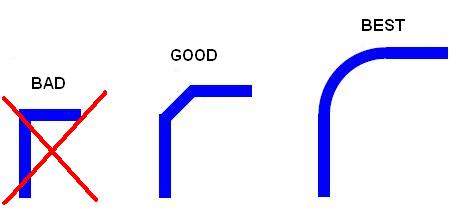

How can I bend a trace like this - refer the trace marked as “best”
http://1.bp.blogspot.com/_Dj6q42y2Hq8/TEwyvQ7RyII/AAAAAAAAAAU/TyZbrPqGzcc/s1600/routing.JPG
Currently you can’t.
You can approximate a bend as a series of angled lines. Getting angles other than 0, 45 or 90 on the OpenGL canvas requires diving into menus
There are scripts for spirals, (as multi-segments) that could be modified, but it may also be possible to directly script ARCs - ie run on a loaded design, via Python.
Has anyone tried this ? (script generate of traces directly, not via a file)
The problem with curved tracks created with many line segments is that they do not play nice with the interactive router, that is they do not drag or shove.
Yes, & that s true of many shove routers too, not just KiCad’s
It is the sort of operation that would be done near the end of a design.
On the default canvas there is an option to drag the trace when I right click on the trace.
In OpenGL no such option - could you be kind enough to point out which menu has the angles.
The only menu I could find was the limit track angle to 45 degrees, but that is not allowing me to make a curve.
See https://bugs.launchpad.net/kicad/+bug/1620585 with an awkward workaround for free angles

What I do for arced traces:
  • In your layout (Pcbnew), use the graphic arc tool to make your trace with a graphical line, pretending to connect two straight traces or two pads.
  • I then view the parameters of the arc and note down all dimensions like angles and position.
  • In footprint editor, make a new footprint with a graphical arc with the same exact parameters and change it’s layer to top/bottom copper.
  • Import the footprint into Pcbnew. Now, you could either edit the footprint beforehand with SMD pads 1 and 2 in both ends, but then you have to include it as a part in your schematic/netlist. What I do instead is just to lay down the new arced footprint where it should go, and route a thinner “invisible” trace behind it (this will be somewhat staggered, but hidden), leaving the arced footprint unconnected.
