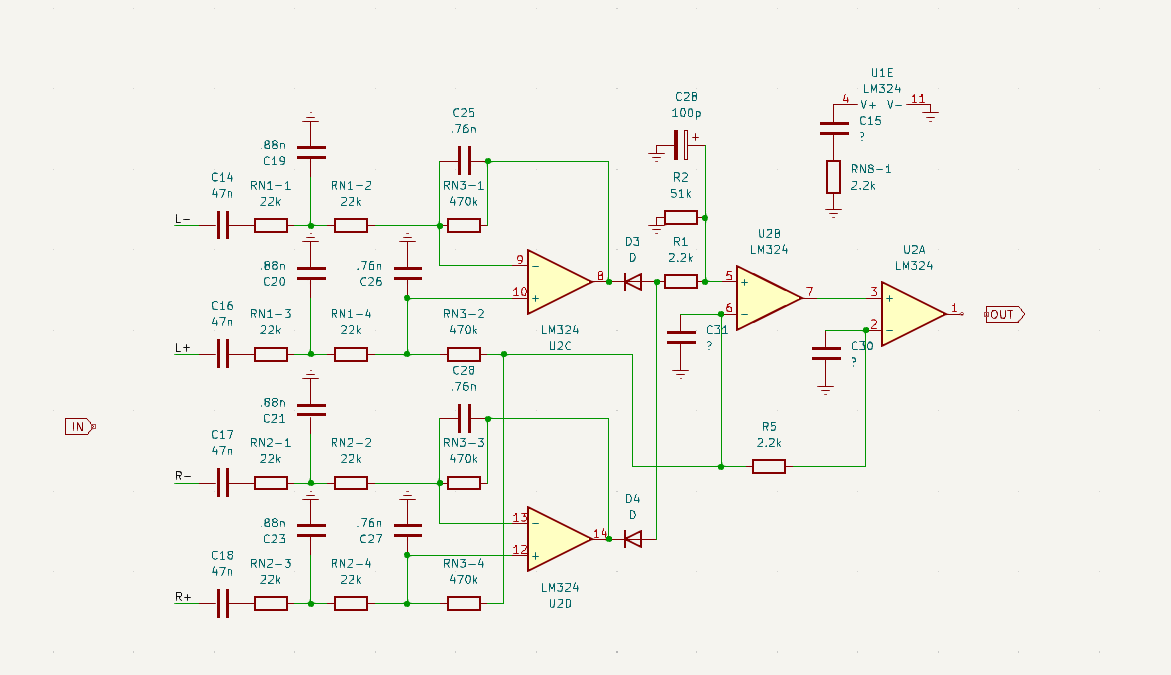

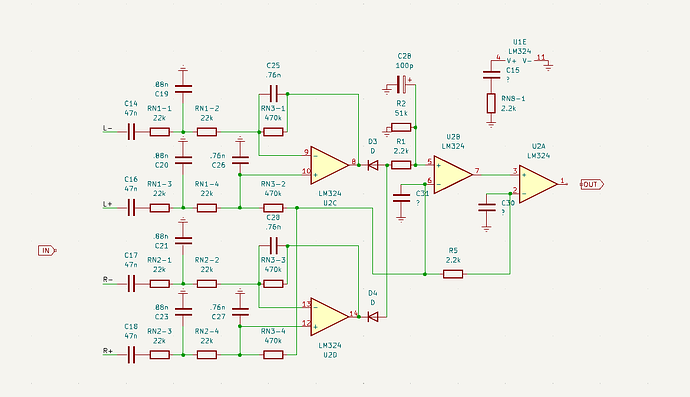

I’m pretty new to drawing schematics. I thought I’d start by reverse engineering something I thought might be pretty easy. What I have is Silence Sensor based around an LM324N and a microcontroller. I think the LM324N is a comparator and that signal is being sent to the microcontroller which is manipulating LEDs as well as a relay. So far, I’ve only drawn the audio section.
What I’d like to do is use the simulator to see what kind of signals the OpAmp is generating. Here’s what I have so far:
I’ve read that the LM324N doesn’t have the proper Spice model(?) for simulations.
First question is: Does this look correct so far? I can upload a picture of PCB if it’s necessary.
Second question: How do I send an audio signal (probably a sine wave) to the inputs and generate a proper simulation?
Schematic looks mostly plausible, but at least the values for C30 and c31 are missing. I also recommend using GND symbols instead of PE, and to put them the right side up. (Just for easier reading).
But for starting with simulations, I suggest you start with something simpler first. There are a bunch of things that can make it difficult to get started with simulations, and building it up in small steps is recommended.

Replace the earth symbol by GND symbol (indeed not a recommendation, but a must).
Connect your in and out labels.
A suitable voltage source is the VSIN symbol, used for transient (voltages versus time) simulation.
Your power supply symbol part U1E is not used adequately. You may watch this video for an example https://www.youtube.com/watch?v=Wg7uSs4J_0U.

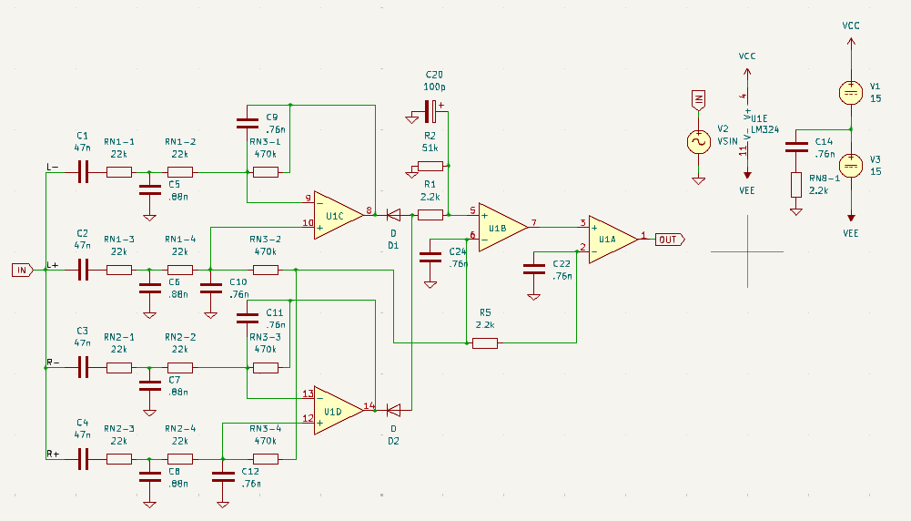

I have updated this given your recommendations:
And using @paulvdh model. However, when I attempt to run a simulation, I get the following error:
Circuit: KiCad schematic
Error on line:
a$poly$e.xu1.xtl074a.egnd %vd [ vcc 0 vee 0 ] %vd ( xu1.xtl074a.99 0 ) a$poly$e.xu1.xtl074a.egnd
MIF-ERROR - unable to find definition of model a$poly$e.xu1.xtl074a.egnd
Command: esave none
I surmise this is an issue with the DC power circuit? I also don’t think I’m doing the audio input correctly.
That error has been solved by install ngspice.
sudo apt install ngspice
