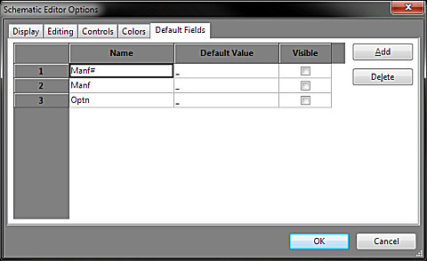

Things you want/need to do:
EEschema>Preferences>SchematicEditorOptions
Add similar fields - read through this “Standard symbol field names initiative” and see what fancies you. Set the Default Value as underscore or whatever - don’t leave it blank, otherwise this field isn’t added when you change parts in the library or add them to your schematic.
Existing parts in the lib won’t get those fields automatically. I hope one of the tools I mentioned do that. If not, either python scripting or text editor..
