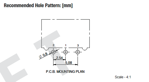

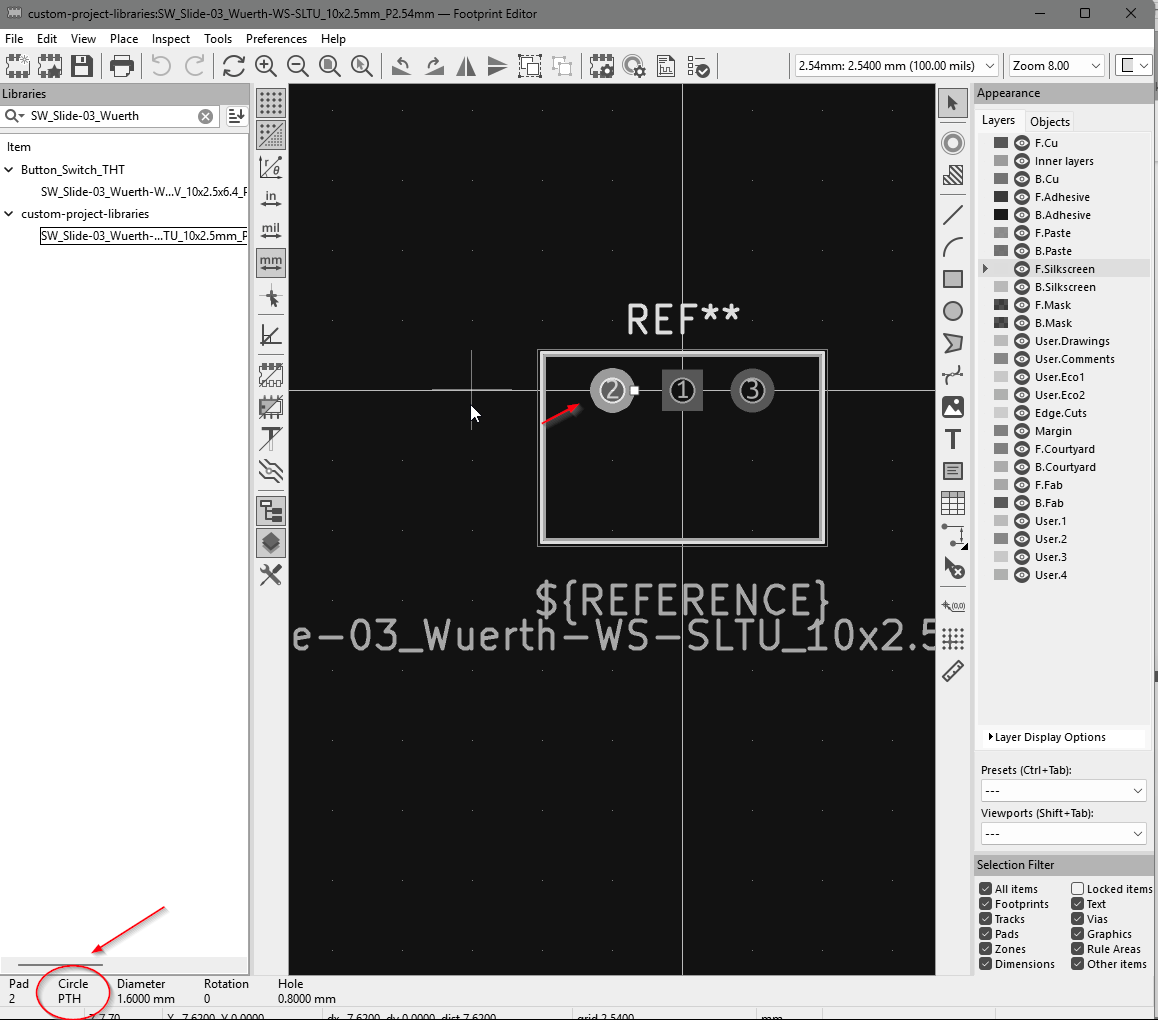

The only modification I am doing from the already available Button_Switch_THT:SW_Slide-03_Wuerth-WS-SLTV_10x2.5x6.4_P2.54mm library is changing the silkscreen and the courtyard, as the SLTU switch is angled and the SLTV switch is not. Otherwise the SLTU switch has the same recommended hole pattern as the SLTV, here is the recommended hole pattern:
Whoever designed Button_Switch_THT:SW_Slide-03_Wuerth-WS-SLTV_10x2.5x6.4_P2.54mm decided to use this recommendation (which sounds reasonable).
I printed my board out on paper to layout-check and noticed that the drill hole size for this slide switch (0.8mm) seems to be a rather tight fit.
Again, from the Wuerth Datasheet, the actual diameter of the pins on the switch is 0.6mm:

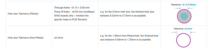

Alright, so it’s a tight fit, but perhaps my manufacturer can deal with it. Here is what they say (from this site, the manufacturer is JLCPCB):
As far as I understand the footprint uses plated through holes:
Therefore, in the worst case I should expect a 8-0.08mm hole, which still is bigger than on the slide switch.

Printing out an PCB is a useful method for checking a lot of things, but it does not have the resolution to judge whether a hole should be 200um bigger or not. The 800um hole size is recommended both by whatever your source was (Datasheet?) and by:
0.8mm should be fine. I suspect it won’t be incredibly tight when you assemble it.
That said, the datasheet value of 0.8mm is indeed a little tight according to IPC hole standards. As the drawing is ISO 2768 “m” tolerance, the max lead size is 0.6 + 0.1 = 0.7mm.
This leaves you only 0.1mm oversizing with a 0.8mm hole, and less if the hole is at minimum size and the lead is at maximum (0.02mm!). But remember the RMS thing from the capacitors - the same principle can be applied if you want.
