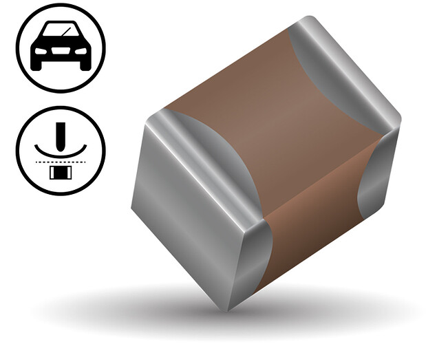

Capacitor 1206 footprint: correct for the parts I will be using?

I’ll use the IPC SM-782 1206 capacitor component sizes and tolerances, as that’s what the library uses. Your manufacturers differ a little.
  • L: 3 to 3.4 mm
  • T: 0.25 to 0.75mm

  • Choice of the component size and tolerances - your part has different sizes and tolerances on BW (aka T)
