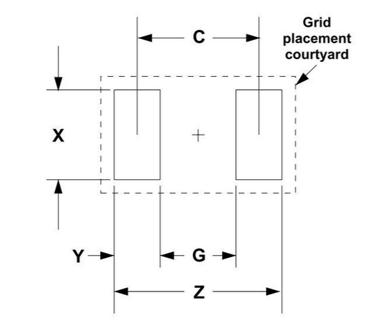

Capacitor 1206 footprint: correct for the parts I will be using?
Hi!
I am changing from THT to SMD capacitors on a board I am working with.
I plan on having the board soldered by JLCPCB but I still chose the “handsolder” footprint for futureproofing.
I am currently looking at two models of 1206 capacitors:
Datasheets are available if you click on the links above and click on the Datasheet hyperlink.
Maybe I am being overly cautious (which is why my footprint selection has taken ages :D), but even if the capcaitors claim a 1206
footprint, I look at their dimensions and compare it with the KiCad footprint editor.
For the CL31B104KBCNNNC samsung part, if you go to the datasheet, https://jlcpcb.com/api/file/downloadByFileSystemAccessId/8579707339533963264,
it says that the length of the component is 3.20mm +/- 0.2mm. For “BW” (the width of the part that will be soldered, the tolerance is 0.5 +/- 0.3mm). See screenshot:
If I am not mistaken, then in the worst case the “BW” will be 0.8mm and “L” will be 3mm. This makes the “gap” between the two solderable parts 3-2*0.8=1.4mm.
However, in KiCad, this distance is 1.8mm:
The worst case is worse on the 4.7uF capacitor due to the other
manufacturer having other tolerances:
Also, the space between the centers of the “1” and “2” pads in is 3.125mm. Seems a bit wide if the capacitor is supposed to be L=3.2 and BW=0.5.
Then isn’t the distance between the center of the pads 3.2-0.5=2.7?
I assume that even though this doesn’t seem to align with the footprint, it will be fine in practise and I can select
Capacitor_SMD:C_1206_3216Metric_Pad1.33x1.80mm_HandSolder with no problems. Right…?

Addressing the question that was originally asked:
These footprints are generated using calculations from IPC 7351B, which is not the only way to do it. In fact, the KiCad library footprints assume component sizes in IPC SM-782, but that same document has very different footprints recommended, with an inter-pad spacing of 1.2mm, but that’s also a much older document from 1996 and PCB assembly has changed a bit in the last 29 years)
First, definitions:
I’ll use the IPC SM-782 1206 capacitor component sizes and tolerances, as that’s what the library uses. Your manufacturers differ a little.
  • L: 3 to 3.4 mm
  • T: 0.25 to 0.75mm
The spacing G is calculated from a number Gmin. Gmin requires to know Smax, which is the maximum space between the leads.
Worst case tolerances:
  • Ltol = Lmax - Lmin = 0.4mm
  • Ttol = Tmax - Tmin = 0.5mm
  • Smin = Lmin - 2Tmax = 3.0 - 2 * 0.75 = 1.5mm
  • Smax = Lmax - 2Tmin = 3.4 - 2 * 0.25 = 2.9mm
  • Stol = Smax - Smin = 2.9 - 1.5 = 1.4mm
IPC 7351B uses an RMS error propagation method rather than worst case:
  • Stol (RMS) = sqrt(Ltol ^ 2 + 2Ttol ^ 2) = sqrt(0.4^2 +2 * 0.5^2) = 0.812
Now, we find the difference between Stol and Stol (RMS) = 1.4 - 0.812 = 0.588mm
Then we add/subtract half of that each to the worst-case min and max (caution: IPC 7351 not-B is different here) to get a “more realistic” (IPC’s words) description of the expected range of S:
  • Smin (adj) = Smin + 0.588 / 2 = 1.794mm
  • Smax (adj) = Smax - 0.588 / 2 = 2.606mm
Jh is the heel fillet goal, which is 0 for a 1206 capacitor footprint at medium density.
Then, Gmin is found from the max lead spacing, minus the heel fillet, minus tolerance adjustment:
  • Gmin = Smax (adj) - 2Jh - sqrt(Stol RMS^2 + F^2 + P^2) = 2.606 - 0 - 0.812 = 1.786mm
F and P are an additional couple of terms here for board manufacturing tolerance and pick and place placement tolerance, but they contribute almost nothing in this case (they start to dominate in smaller footprints). KiCad currently sets these to 0.1mm and 0.05mm respectively.
Finally, round off to 0.05, so 1.8.
This is how the footprint pad spacing is calculated. There are lots of choices embedded in this process:
  • Choice of the component size and tolerances - your part has different sizes and tolerances on BW (aka T)
  • Choice of error propagation method - you can choose to do worst-case rather than the RMS-based system, or bias more towards worst-case
  • Choice of heel fillet allowance - you can choose to have more or less (in fact IPC 7351 non-A had a negative fillet of -0.05).
    • IPC density levels can affect this, but in the case of capacitors like this, it’s 0 at all three levels (most, nominal, least)
  • Choice of using a completely different system (e.g. manufacturer guideline or IPC SM 782 footprints or whatever your boss read on the back of a cereal box this morning)
You may find the library choices unsuitable for your needs, and that’s completely reasonable.
For example, you may not agree that the RMS tolerance system’s assuming that worst-case tolerances won’t usually co-exist is a “safe” thing to do and worry about the worst possible in-spec case: a 3.0mm part with two 0.75mm terminals:
Even this edge case probably would solder just fine, as you still have plenty of terminal overlapping there. But you may wish to add some heel, or be more careful with traces passing near the inner edges, which could touch the terminals and be separated by only solder mask.
The good news is probably many millions of these parts have been used on KiCad PCBs (and 1206 is a very, very common part to use), and we aren’t inundated with complaints, so they probably work well for most people. You are always right to check, however.
This is meaningless for hand soldering variants, as they have an extra extension on the outer edges for your soldering iron, so the centres are always going to be further out.
Even without that, the IPC 7351B toe fillet goal at medium density for a 1206 capacitor is 0.35 and the heel is 0, so the pads will be slightly biased towards the outside. You can see this in the footprint with nominal 0.5mm leads drawn in:

Thank you guys for the very insightful information. Sorry about the late reply, I’ve been having fun with the silkscreen lately.
I decided to go with C_0805_2012Metric_Pad1.18x1.45mm_HandSolder, i.e. 0805 caps. I picked the handsolder variant for futureproofing as said in the OP. Hopefully JLCPCB will be able to handle them.
So I will be using these two parts:
CL21A475KAQNNNE | Samsung Electro-Mechanics | Multilayer Ceramic Capacitors MLCC - SMD/SMT | JLCPCB and CL21A475KAQNNNE | Samsung Electro-Mechanics | Multilayer Ceramic Capacitors MLCC - SMD/SMT | JLCPCB.
The reason I am using 0805 is that I was recommended 0805 resistors in another topic; my resistors are already 0805, satisfying to use the same cap size.
0603 seems more popular so I might make the switch someday :wink:
Funnily enough, 0805 capacitors are the only size the KiCad libraries make an exception for in the above calculation.
Because 0805 caps (not resistors) have proportionally abnormally loose tolerances on the terminal lengths, the pads end up really close together and inhibit routing under the part:
So we use a “guesstimated” Tmax of 0.55 instead to give a bit more clearance in S.
As Piotr says, it’s probably not required to overthink this too much - KiCad library footprints often differ substantially to vendor recommendations (I believe think many of which are just made up and have little empirical basis), as well as footprints in other libraries. However, we rarely get complaints about them, except when there are actual mistakes. So the unscientific evidence is that things just aren’t that sensitive at the low volume/low reliability end of things where humans look at the products.
If you were going to solder 2 billion capacitors down at 10 million a day in a lights-out factory you would probably do extensive tests on the actual equipment you will be using and make tiny adjustments for tiny gains in reliability (and substantial gains in cost savings). You’d also probably be using tiny weeny parts to save more money!
