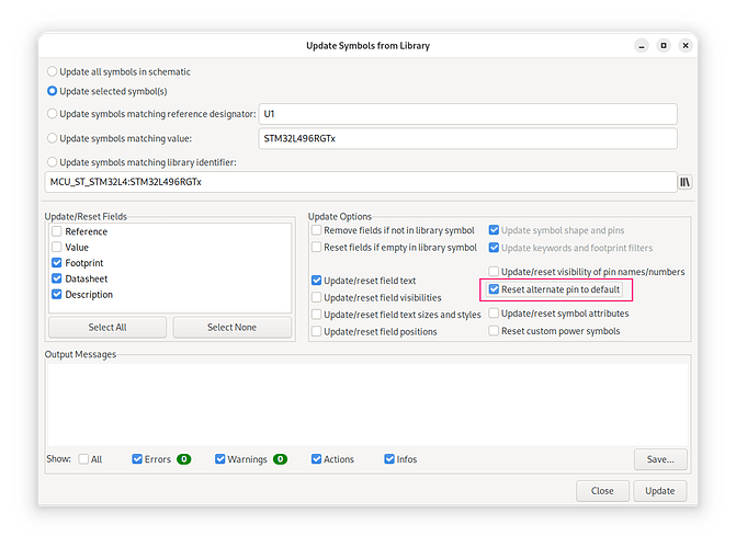

An option to reset the alternate pin definition back to the default pin has been added to the update/change symbol dialog. This will be back ported to 9.0 because it contains a few pin alternate bug fixes and improves the dialog layout which was getting a bit too tall.
