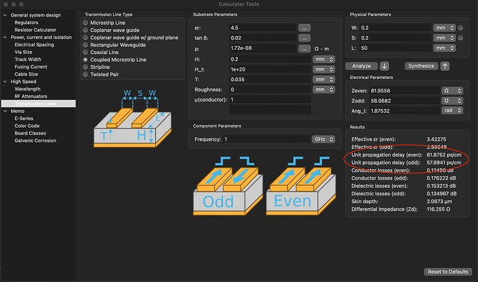

To assist with entering propagation delay values for the delay tuning setup above, the PCB Calculator now calculates unit propagation delays for microstrip, coplaner wave guide, coupled microstrip, and stripline geometries :

The PCB Calculator now provides analysis and synthesis of symmetric coupled striplines. This implements the standard calculations found in
S. B. Cohn, “Shielded Coupled-Strip Transmission Line,” in IRE Transactions on Microwave Theory and Techniques, vol. 3, no. 5, pp. 29-38, October 1955
and
S. B. Cohn, “Characteristic Impedance of the Shielded-Strip Transmission Line,” in Transactions of the IRE Professional Group on Microwave Theory and Techniques, vol. 2, no. 2, pp. 52-57, July 1954
