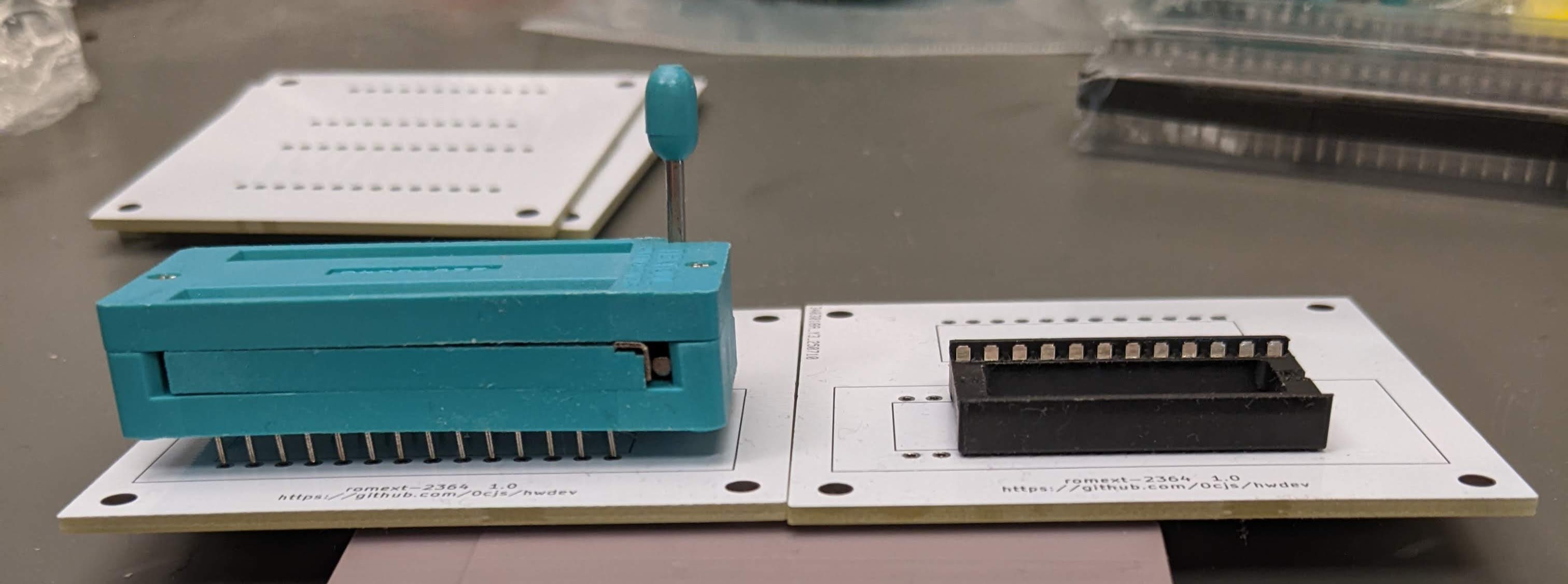

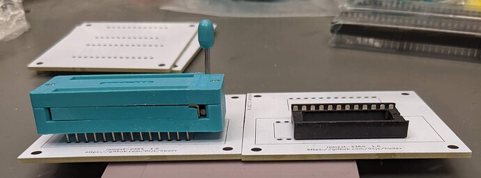

I recently designed a spun a very simple board that just connects a couple of DIP sockets.

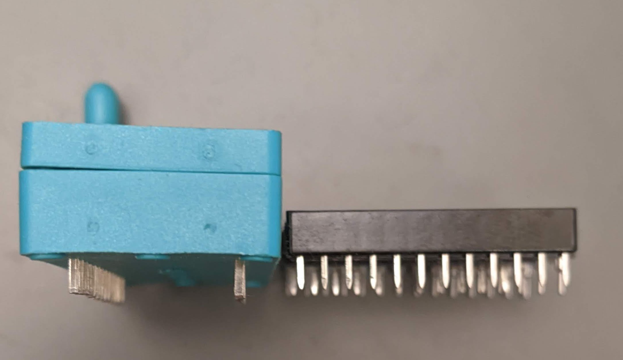

On receiving the result from JLCPCB, I’m extremely frustrated that though my standard dual-wipe and machine-pin sockets fit into the board just fine, the ZIF socket that I designed this for doesn’t go in. While the clearances for the larger, uh, “courtyard” I guess you call it? and the handle and so on are all fine, the ZIF socket pins can’t fit into the holes on the board, because the ZIF socket pins are apparently bigger than “standard pin size.”
The problem is that the footprint I’m using is Package_DIP:DIP-28_W15.24mm, which has 0.8 mm holes. I had searched for “ZIF” in the footprint library, found nothing, and so I used the DIP footprint that turned up in the first few dozen search results for “DIP-28.”

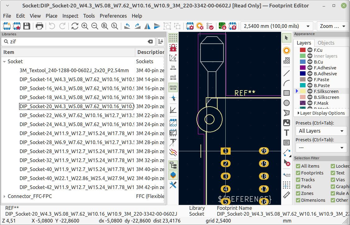

I now see that there’s also a Package_DIP:DIP-28_W15.24mm_Socket footprint (that comes up much later in the search results), which has the 1.0 mm holes I apparently need, and is even described as “3M 24-pin zero insertion force socket, through-hole, row spacing 15.24 mm…” But of course this doesn’t come up when you search for “ZIF”.

I just did a search for zif in KiCad’s default libraries, and KiCad finds a whole lot of 3M textool sockets. I checked the hole size of one of them, and it’s 1.0mm, and that is usually enough for the “normal” square pins.
Becoming frustrated very rarely helps with anything. I hope you can turn your frustration around and consider it as a good lesson to triple check your work if you start modifying symbols or footprints. It’s not difficult to make changes, but it has to be done meticulously. There are many area’s where small mistakes can be made, and small mistakes can lead to big errors.

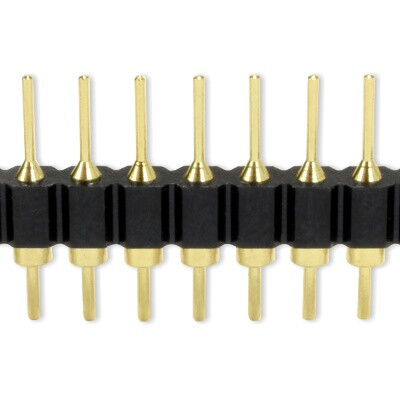

One way to fix this mistake is with headers with round pins. These are thinner then the square pins. So you can solder one end to your ZIF socket pins, and solder the other end into the PCB.

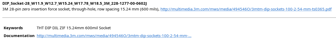

On my schematic I’m using the 2764 symbol (modified in the schematic editor for my purposes). This has a footprint filter of DIP*W15.24mm*. When, in the schematic editor, I go to assign a new footprint I assumed that the ZIF sockets would match that filter and so didn’t turn it off, but searching for “zif” with that filter on turns up nothing because the name of the symbol I need is DIP_Socket-28_W11.9_W12.7_W15.24_W17.78_W18.5_3M_228-1277-00-0602J which is missing the mm part after W15.24.
And I see now that, though ‘ZIF’ is in neither the name nor the description, it is in the Keywords field:
(As is 15.24mm as well, though of course that won’t match the footprint filter, which I presume matches on footprint name only.)
So the first lesson is I suppose always disable the symbol’s footprint filter if you’re having trouble finding what you need because the names are not perfectly consistent.
As for the name issue itself, should the ZIF sockets include mm after the widths, as regular packages do? Or is the footprint filter for the 2764 (and 27C64) symbol wrong, and it should not include the the mm? Or is this apparent inconsistency deliberate for reasons I’m not aware of?

I just grabbed a Textool zif socket from my components boxes: pins are 0.77mm x 0.32mm, so will fit a 1mm hole easily! (I bought these ZIP skts to be able to quickly change PIC chips for software testing… normally the chips just get soldered into the PCB, and mine didn’t fit the PCB, so I bodged it by soldering on some long pins that DID fit the PCB! This was a 1-off situation)

Best I understand it, you were looking for ZIF sockets in the Package_DIP library, and that is not where they are. They are in the Socket library.
