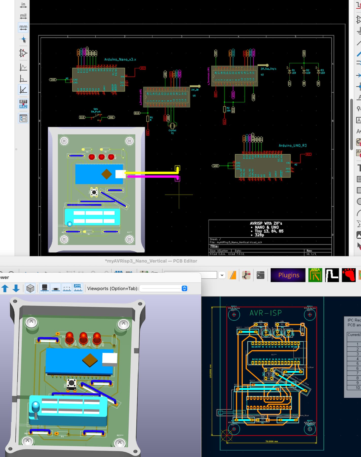

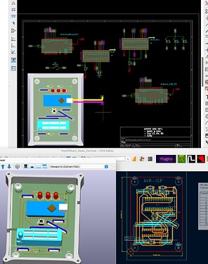

Thus, for me, the most useful way of thinking about them in Symbol’s is as shown below…
I’ve made several Programmers using ZIF’s (and I have a dozen different brands from many years of using them… )
You could simply draw a representative ZIF shape around the Chip and/or place a Screenshot into the Schematic (as shown below)…

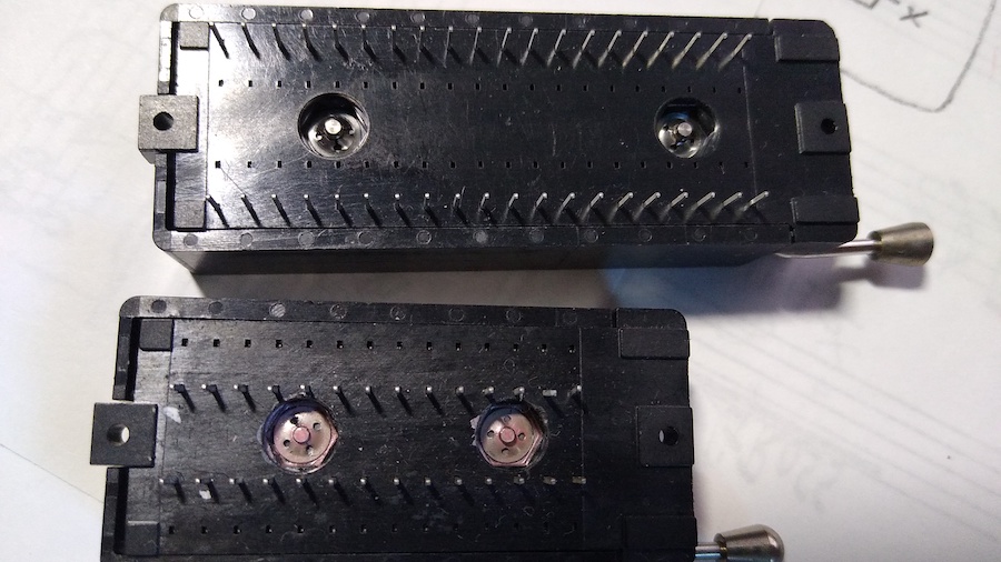

Regarding the Width: Except for the inexpensive TexTool Zif’s, all of my other one’s (More expensive brands) have changeable Width (you open it up and rotate the hardware - see image below… the extra Pin-Hole’s)

All of the Expensive (high-quality) ZIF’s that I have contain Round Pins of 0.6mm Diameter (look at the photo I posted). Only the Inexpensive TexTool ZIF’s (that I have) use Wider Flat Pin’s.

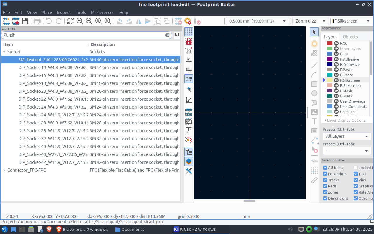

This is what I get when I open the footprint library in V8.0.9 and just enter “zif” in the search field:
And guess what? All the holes are 1mm.
