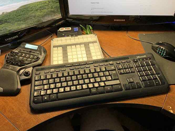

looks like your about to launch your rocket into space
I rarely go to a menu or type a hotkey.
The left Gamer Pad is fully programmable, and has All I need depending on which Tool it detects.
You still need a hotkey to open and close Placement mode.
