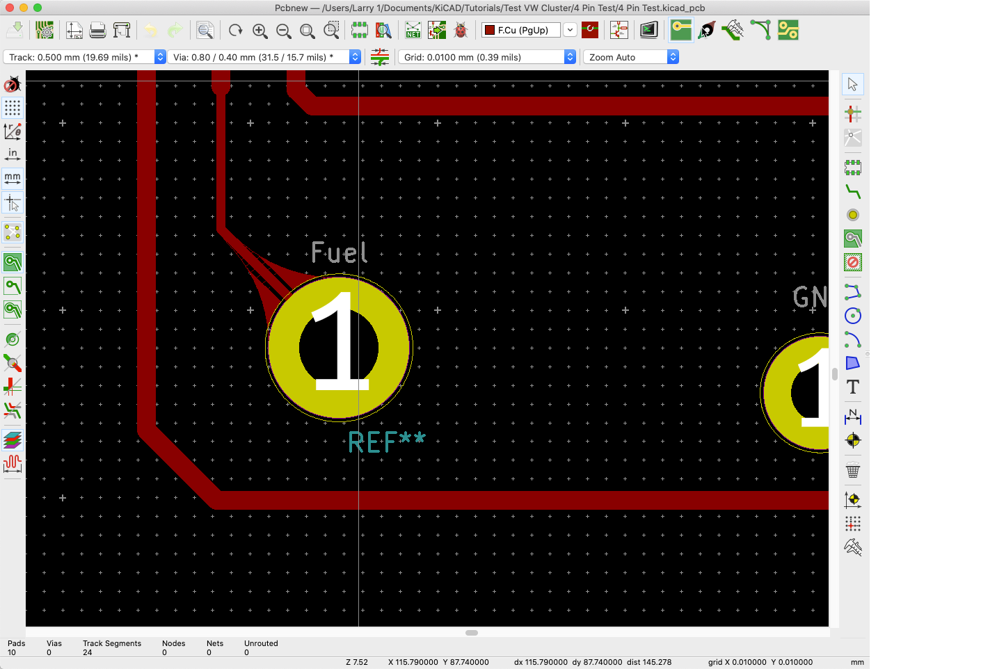

Hi everyone,
Newbie to KiCAD and schematic design, watched many videos, tutorials, etc.
I created a small test circuit with just traces to play around with Pads and edge cuts.
When I create Pads, they look fine in the footprint editor.
But when I drag them to the PCB, it adds a small line around it, which seems to mess up traces, teardrops and other things. What setting is this, am I doing something wrong here?
TIA
my understanding is it’s showing the “clearance” of the pad, which would be more apparent if you had a filled plane on your top layer.
Same here. Those lines are very likely for the clearance.
You can change the view of the pad clearance with the checkbox:
Pcbnew / Preferences / Preferences / Pcbnew / Display Options / Clearance Outlines / [x] Show pad clearance

Turned it off and it removed from the pads, but still seems to impact Teardrops.
Clearance Off
Hiding the clearance indicator doesn’t remove the clearance itself.
Judging by your footprint having REF** reference it didn’t come from schematic and probably doesn’t have a net. That would be why teardrop doesn’t work, they are essentially zones and zones don’t connect if they don’t have a matching net.
and i would imagine the trace that runs through the teardrop also has a default clearance established
To me it looks like you’re approacing it from the wrong side.
The clearances are real no matter whether you show the ring or not, as others have already posted. The clearances are also mandatory and very usefull. Without them KiCad would be worthless.
Teardrops are currently not integrated into KiCad, so you’re probably creating them with some script. I have never used these scripts and do not know what they exactly do. I assume they create a zone on the boundary between the pad and a track segment. The solution should be to make the teardrop itself part of the same net as the pads, so the clearance is not calculatated around the pad, but around the combination of the track + pad + teardrop.

You need nets to make zone based tear drops work.
Your options are:
  1. Create a schematic, it will take 5 minutes if it’s just a bunch of connectors wired together.
  2. Use WireIt plugin to create a net and manually assign that net to tracks and pads that need to have a teardrop
  3. Manually draw the teardrop using copper polygons (not zones).

I just found this setting…which maybe the issue.
Clearance was set at 0.2mm
When I change it to 0, it seems to go away.
And also found it in the properties of the teardrop at 0.2. If I change it to zero, it goes away. So, must be clearance settings as previously mentioned.

It seems that the clearance setting fixed the other SMD pads, but as you say the teardrop plug-in still is an issue.
